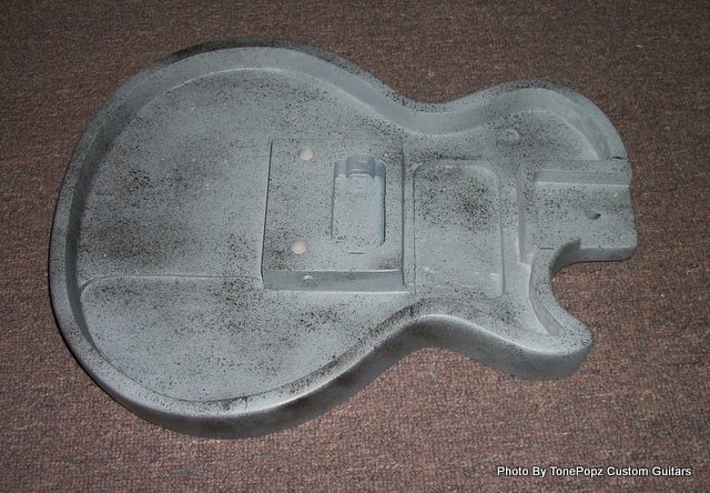

Body thickened 10mm and the roughed out routing to get the depth required.

Tony, what would it be like if the body wasn't thickened?

Genebaby wrote:Tony, what would it be like if the body wasn't thickened?
After the rountings been done it would be too thin as i need to house battery and electronics as well as the light board all inside.The LP Jr ends up 50mm thick so about the same as a regular Les Paul.

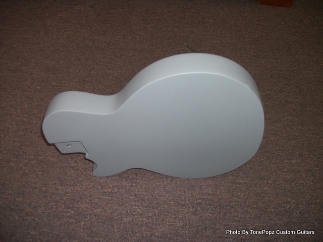

Here's the bodywork nearly done.

Im wondering if a LP Standard could get away without thickening the body.
I always wondered why Ace didn't use a Standard or Custom for the build.

Genebaby wrote:Im wondering if a LP Standard could get away without thickening the body.
Flashers have to be a flat body guitar, the UFO's are an arch body.

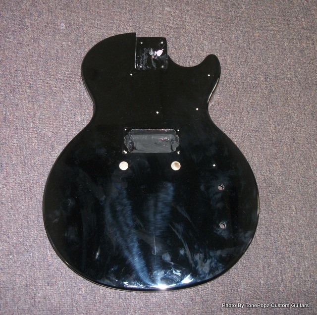

Re: Another Ace Flasher for US customer...
Ok, so you couldn't route away the carved top and work with that?

Genebaby wrote:Ok, so you couldn't route away the carved top and work with that?
I had actually never realised that about the flasher. I wondered why Ace had a guitar with dots.
The pup area ends up higher than the perimeter of the guitar and the flat plastic face wont fit.
