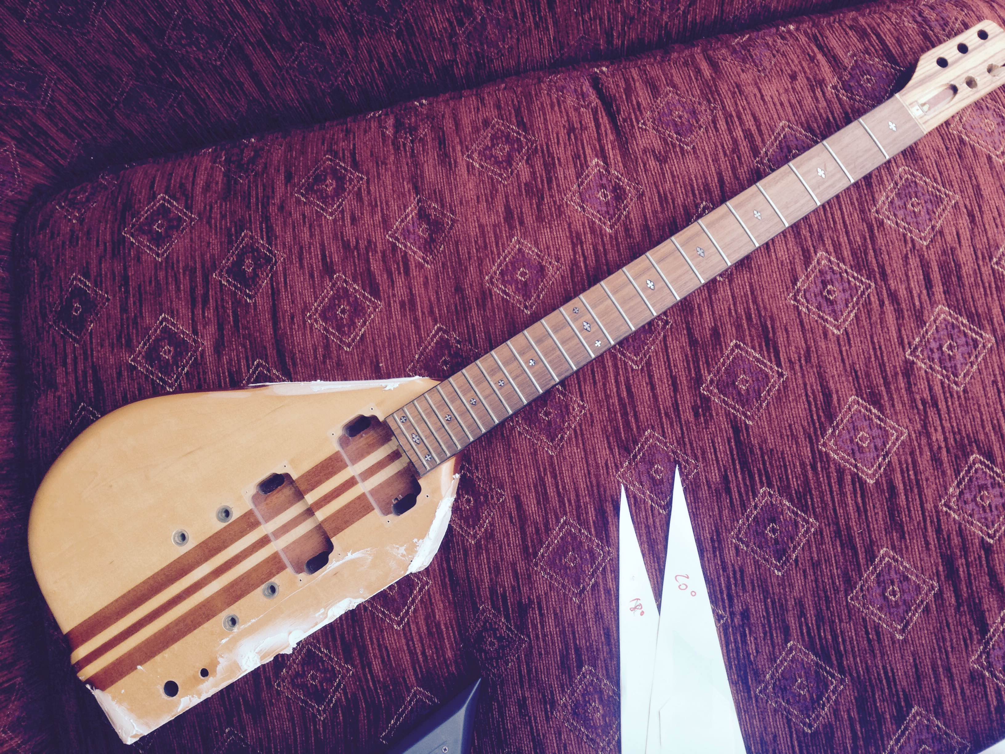

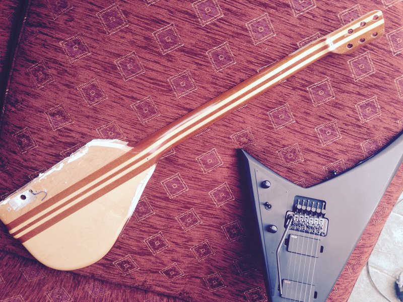

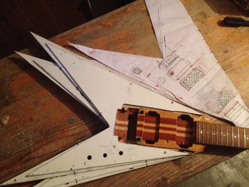

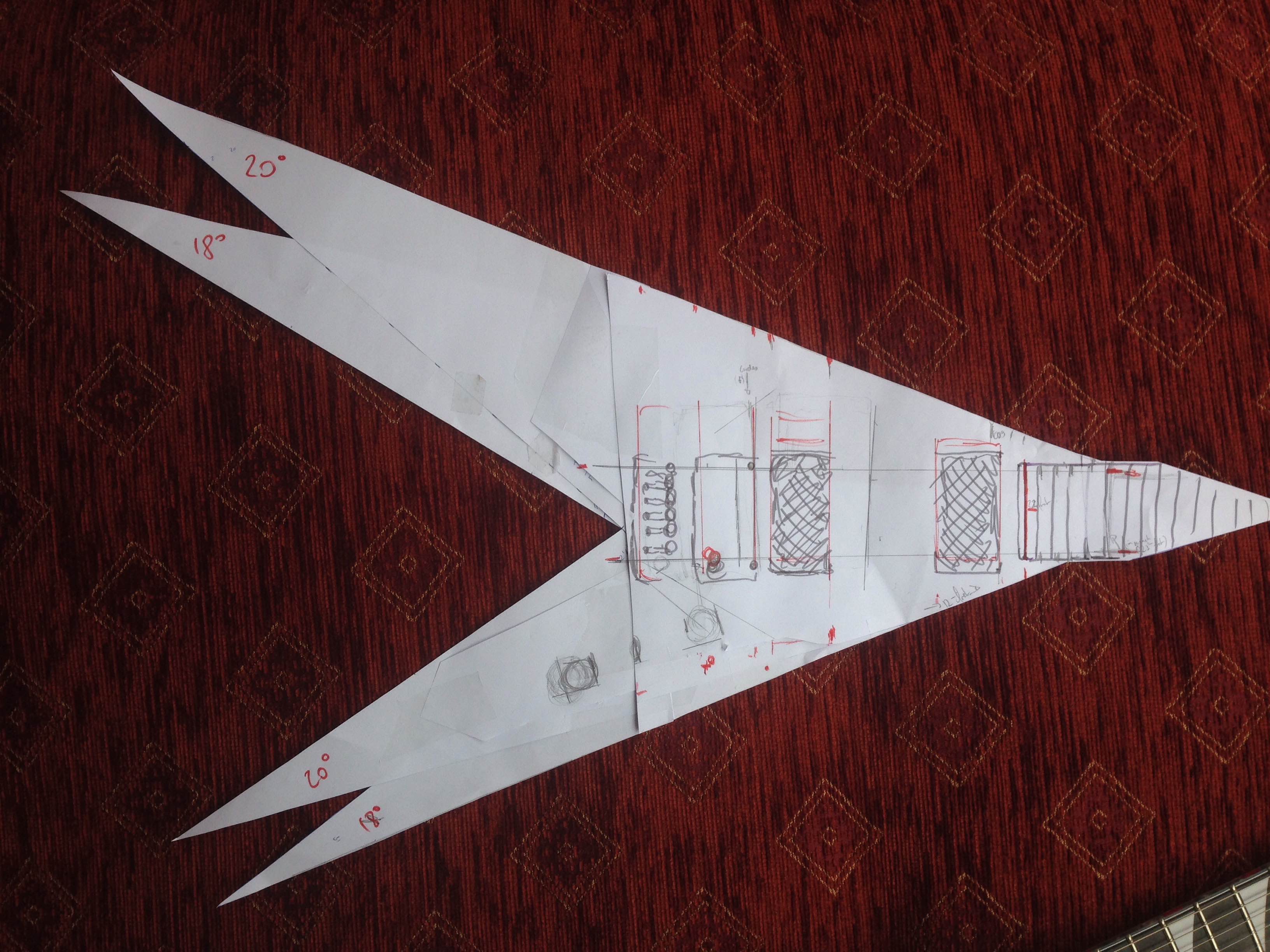

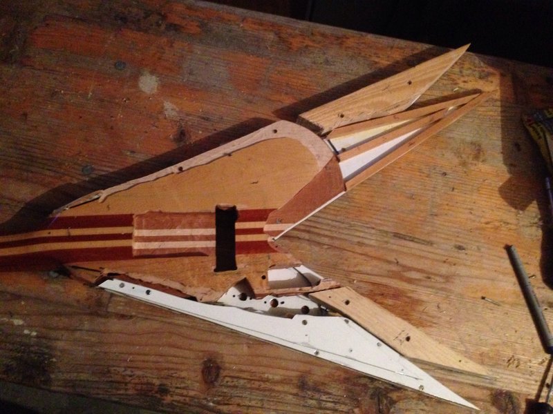

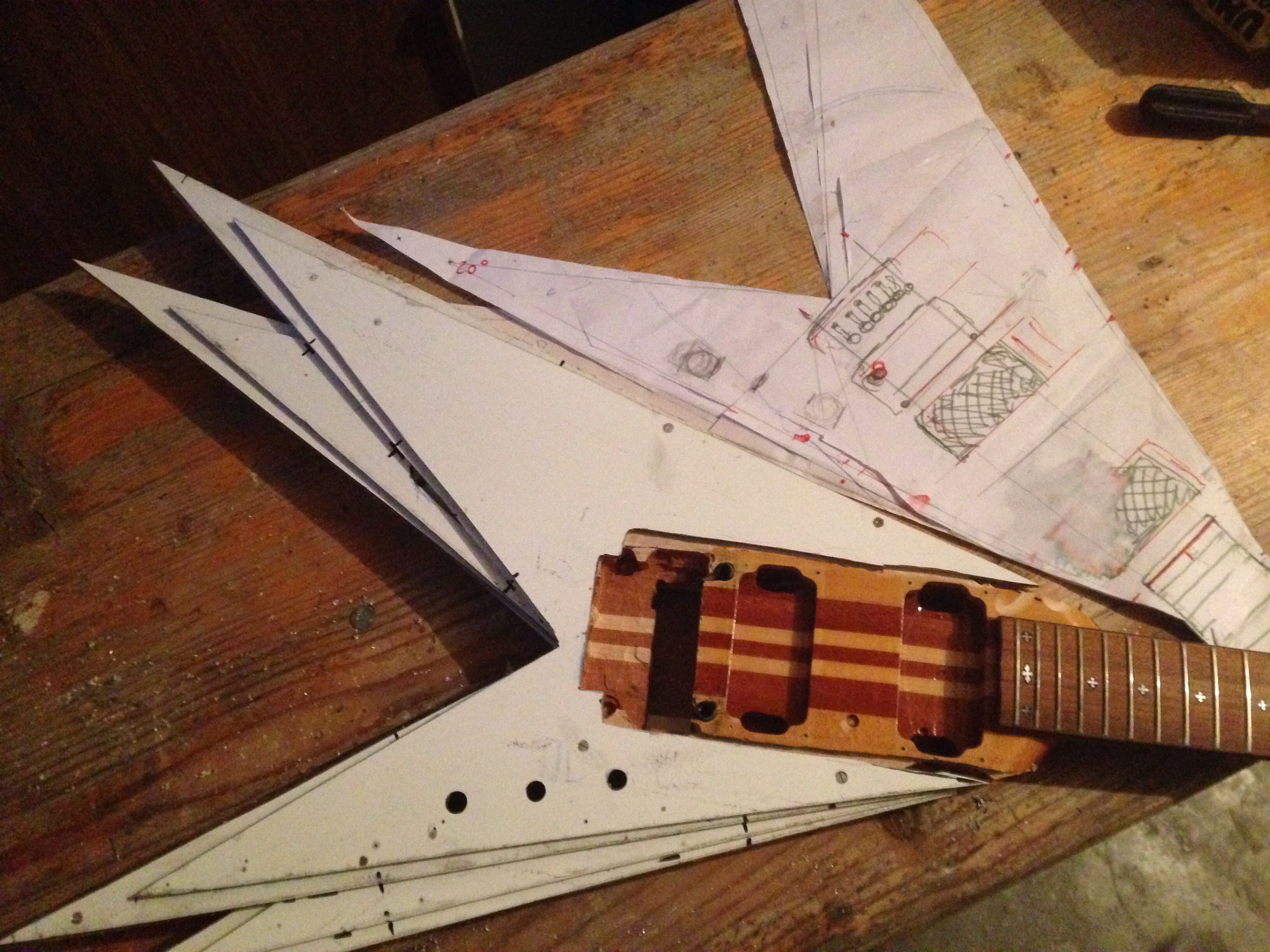

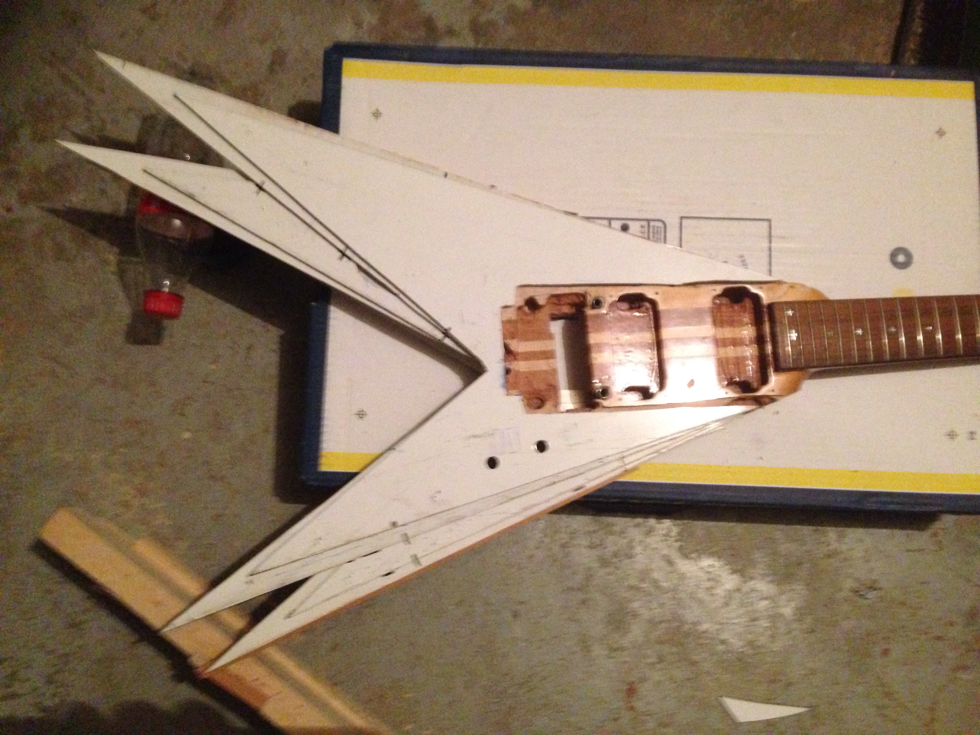

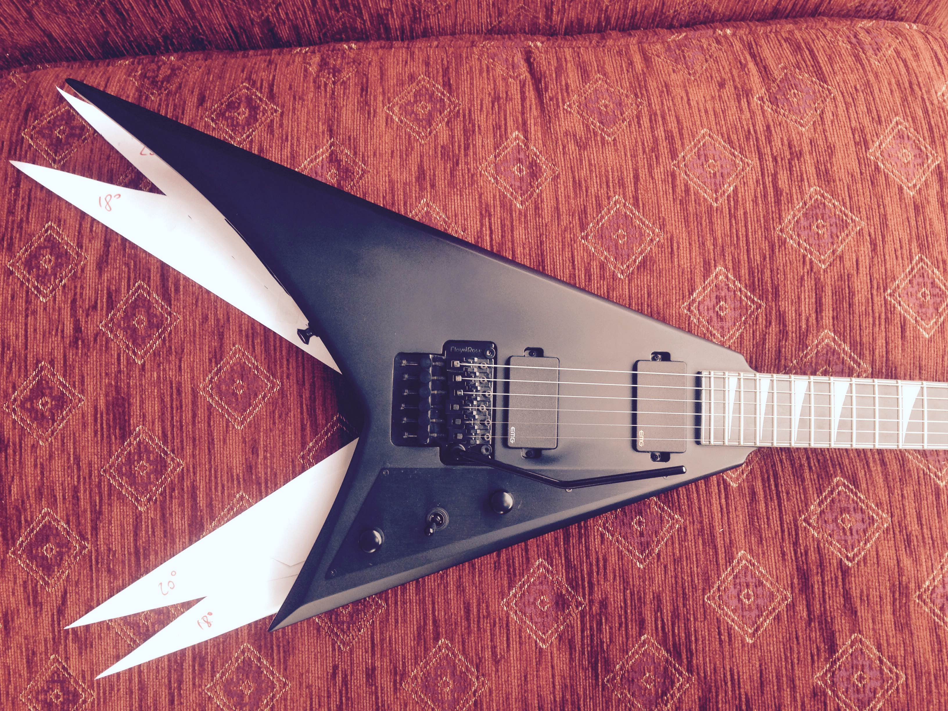

As I was thinking about buying another guitar to calm down my GAS (I’ve noticed some nice guitars I don’t have, like some US Telecaster, or a Jake E lee style Charvel, or a Gibson SG…), I remembered my old VV project that involved transforming an old wrecked Matsumoku guitar into a VV model. No money to spend here, but a lot of work to do…

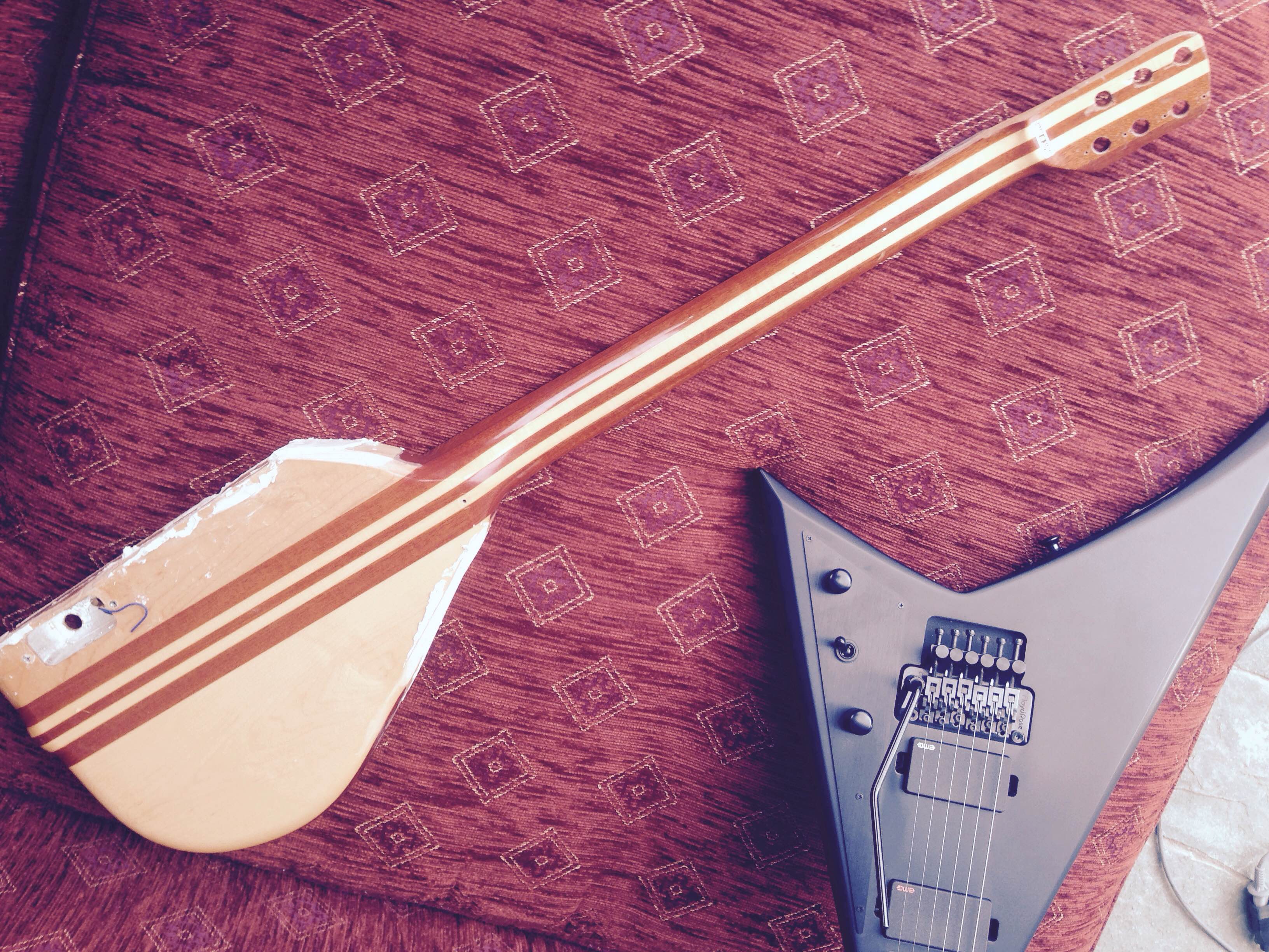

I checked and observed the pictures I found on the net. My Jackson RR pro helped me to do the first drawing too. I didn't think VV guitars were so big...
If you (guitar pros especially) won’t make too much fun of me, and if Vinnie won’t sue me for this :evil: , I’ll show you the next steps of my handyman project. It’ll take a while, but I’m sure I’ll be faster than TJ Monster to finish mine :D
Here are some picture of all this :

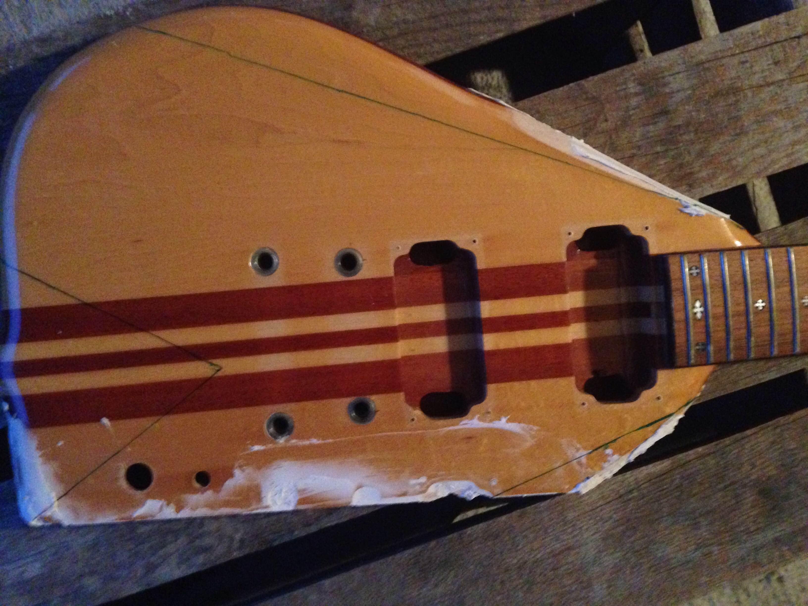

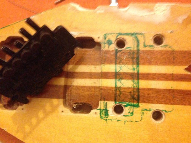

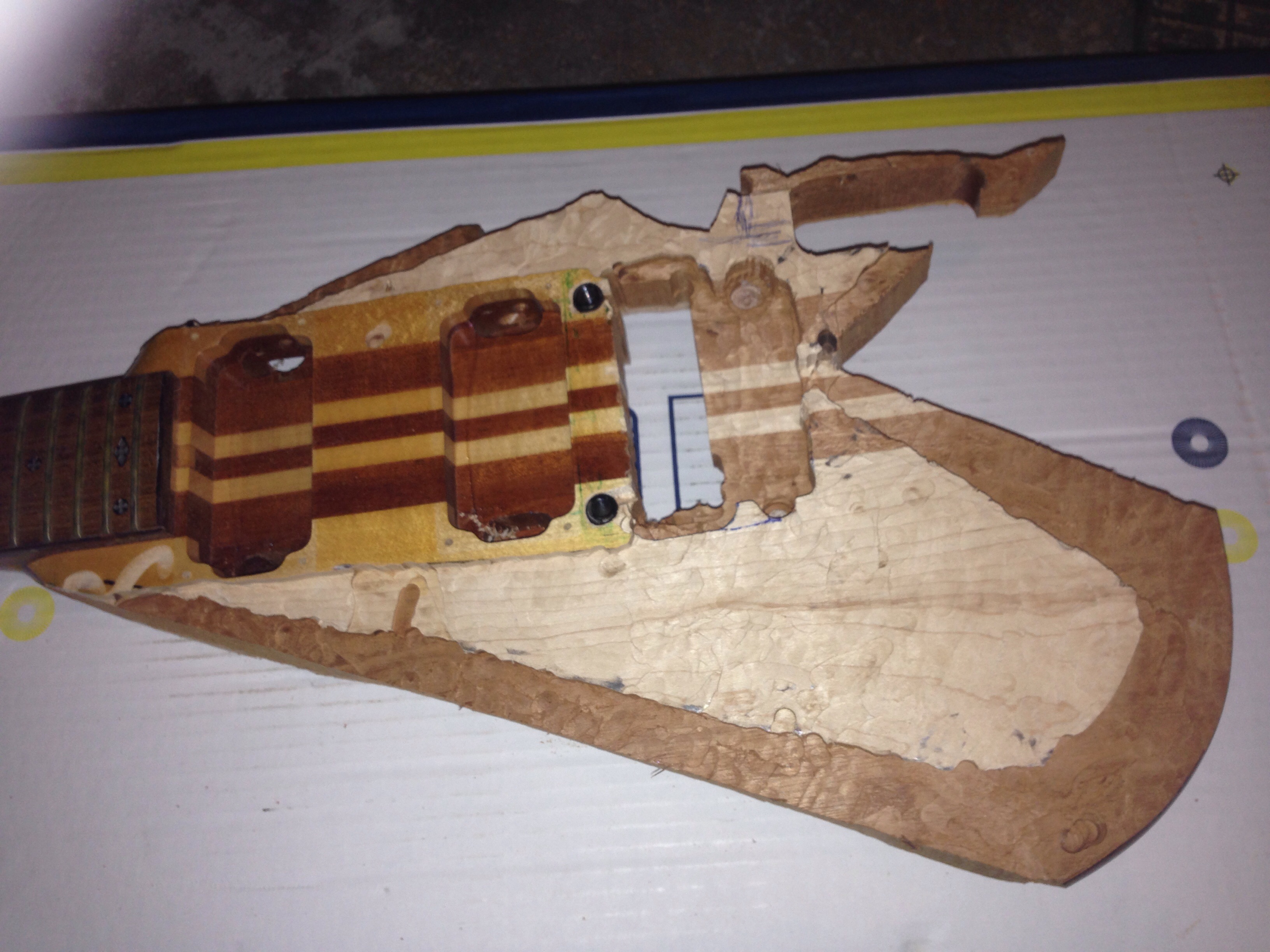

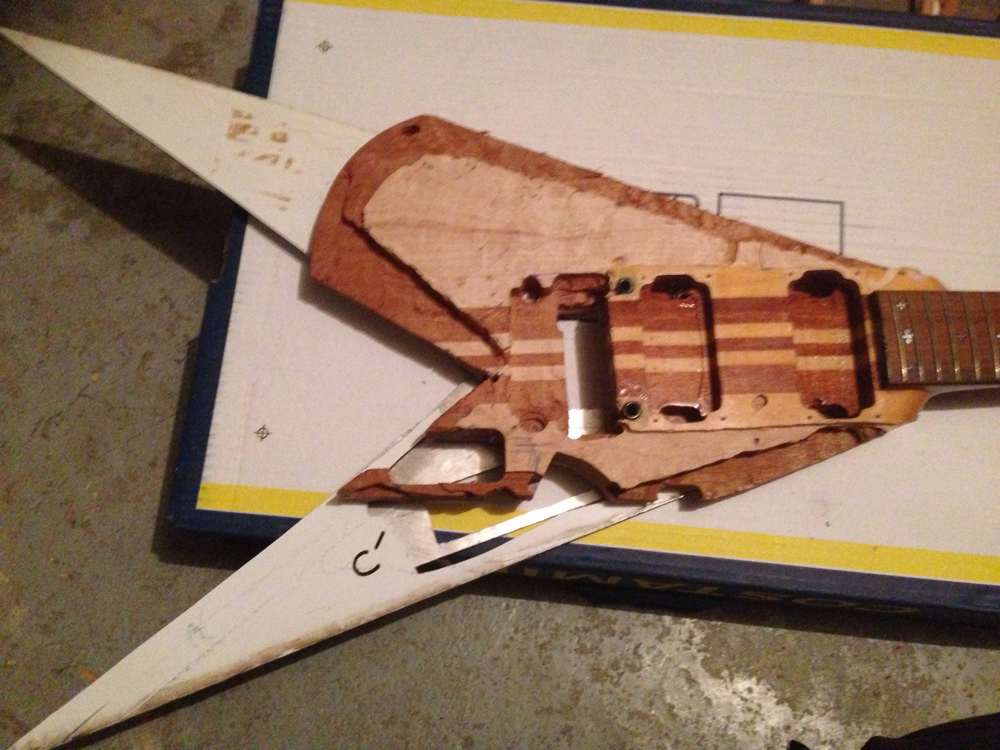

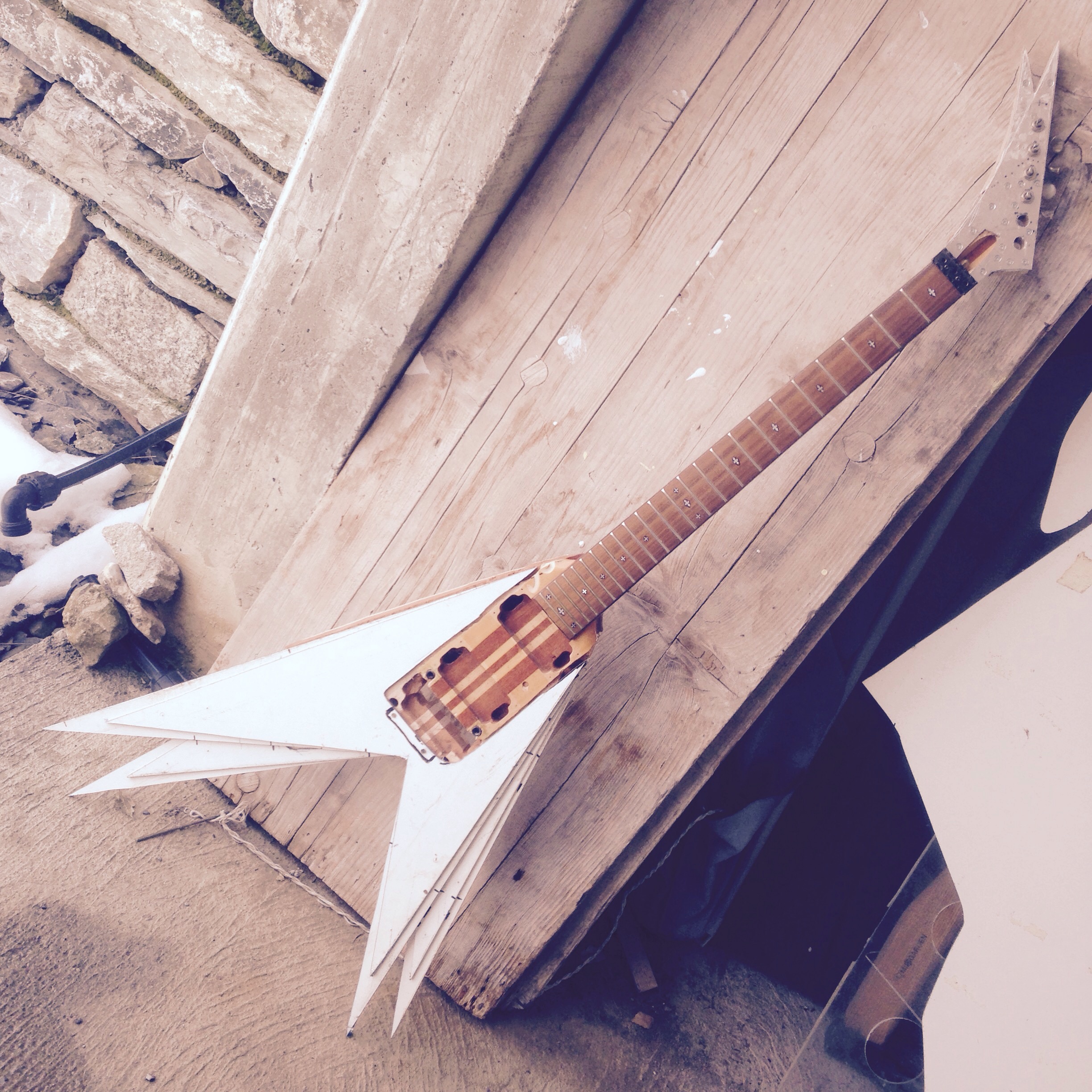

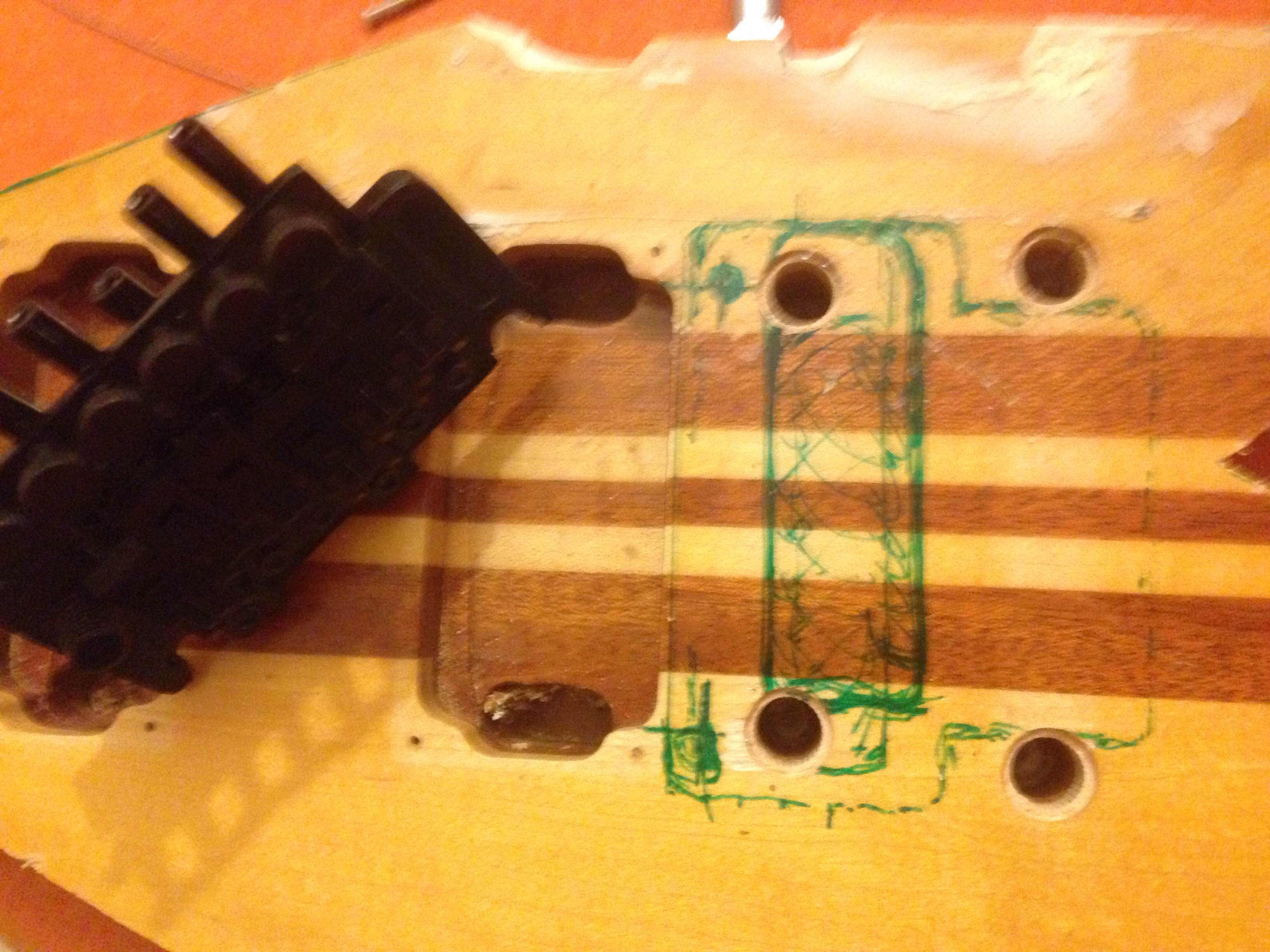

I did some job today on the guitar, slowly : I cut some wood and prepared the place for the Floyd. I also found a name for this guitar . It will be the '86 TRASHBIN PS , as it came from a trashbin and the color will be pink and silver. Still a long way to go...

The fret board pattern is cool, but I'd like to have the Jackson marks. The problem with the actual marks is they won't be covered by the Jackson marks... I'll have to decide...

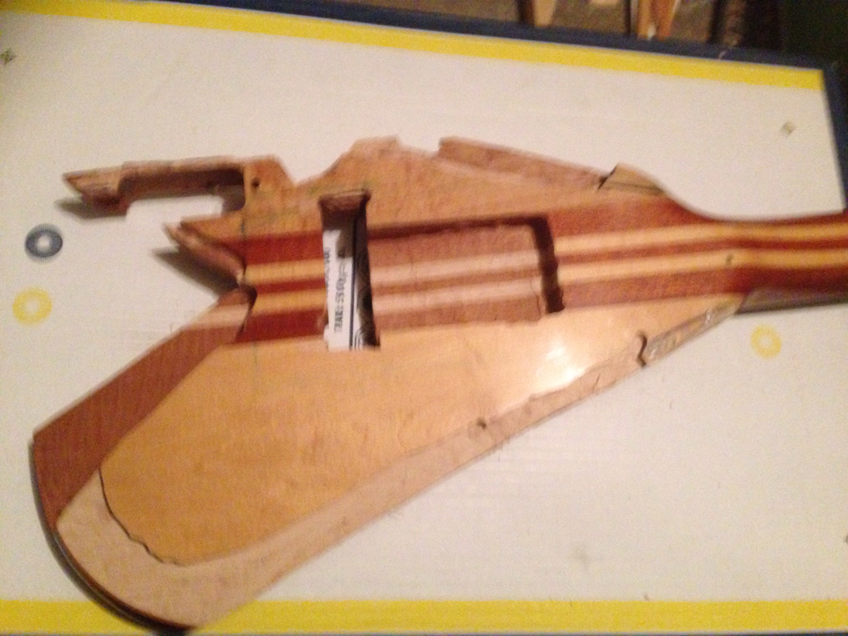

The headstock is damaged, but I think I have a solution...
Pics will follow. I've been busy with the Floyd installation. I sincerely hope no luthier works like me...
The important thing is that I still think I'll succeed!
It would have been though much more easier to work on a Jackson with a Floyd...

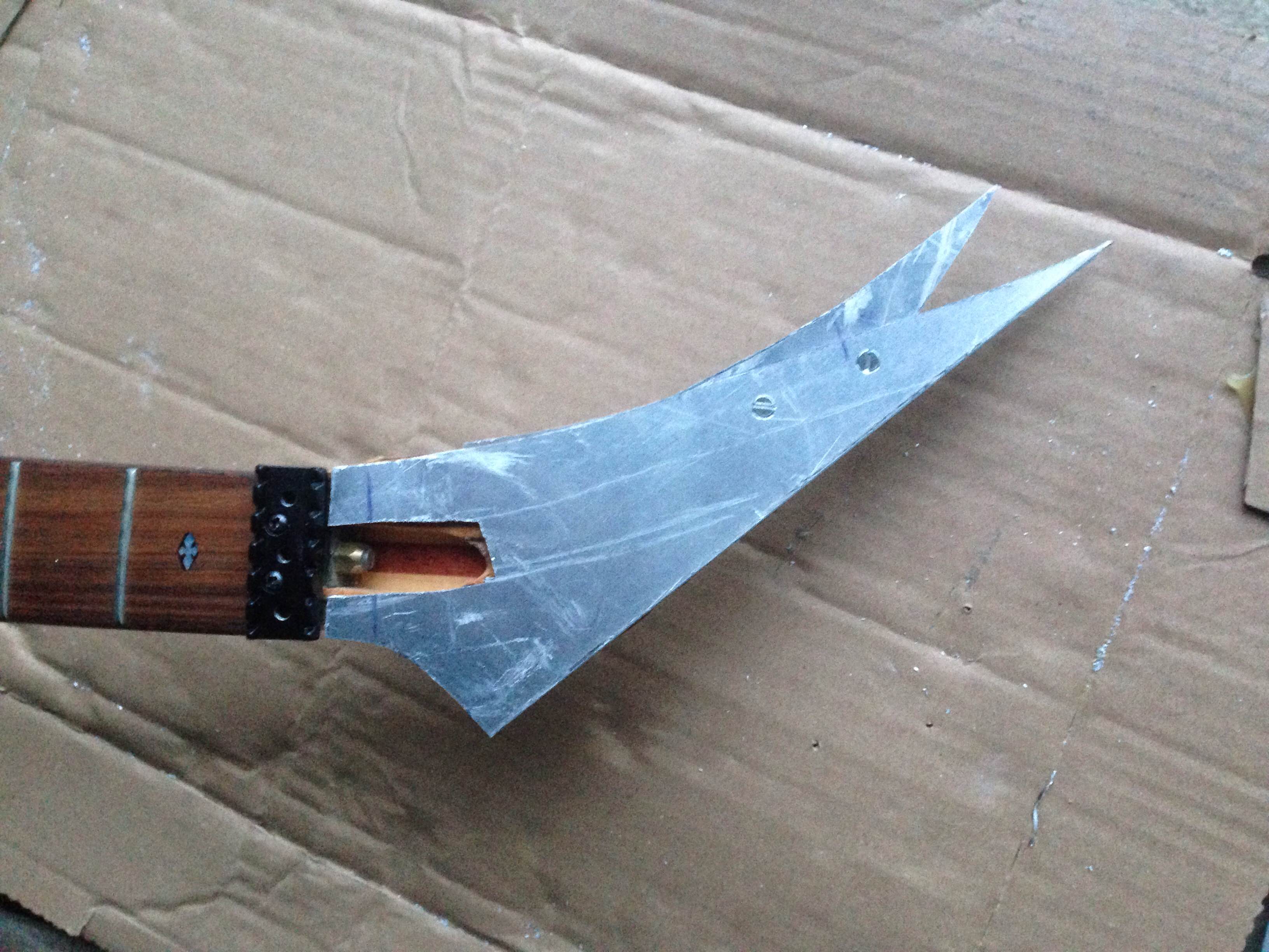

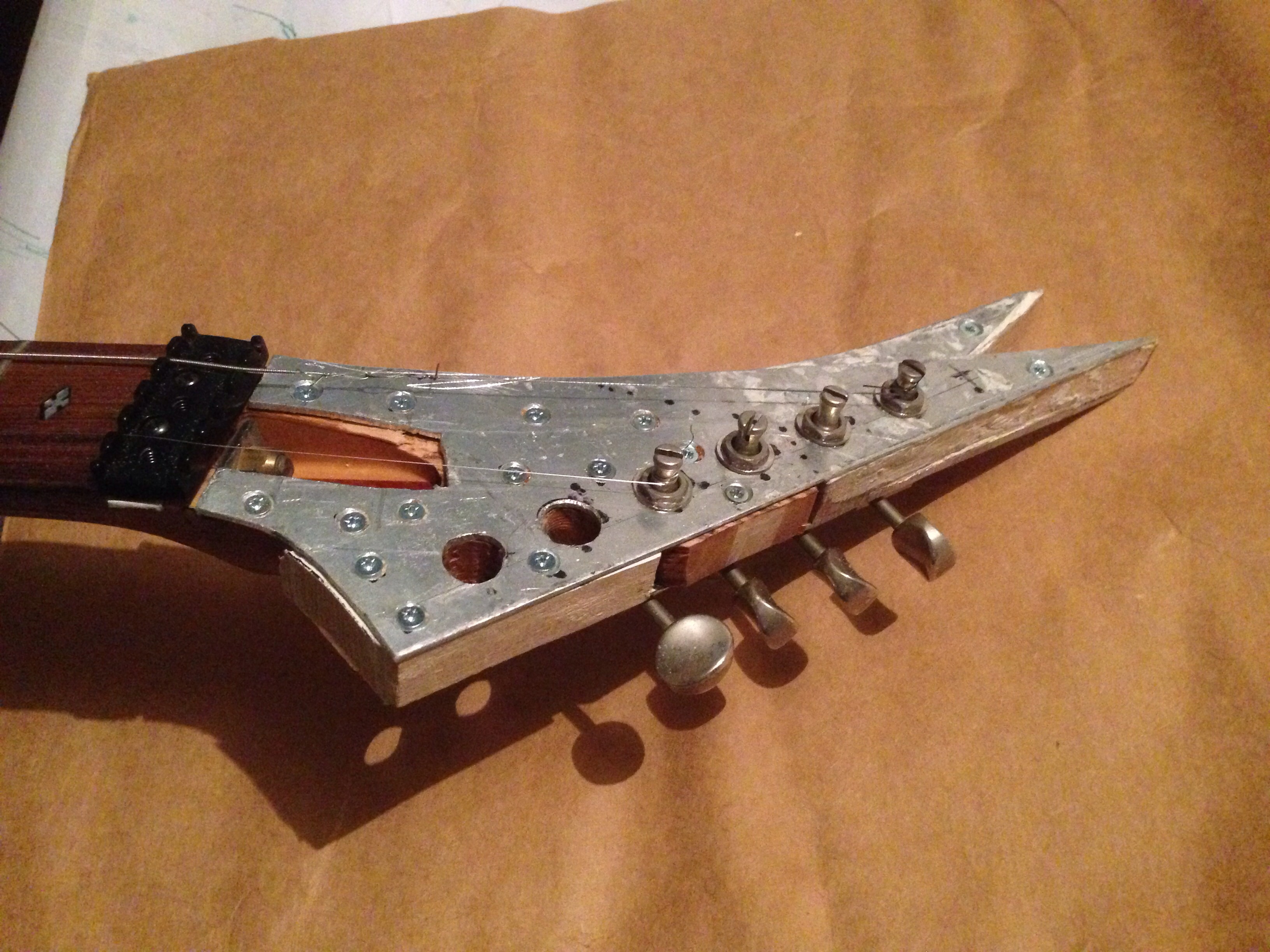

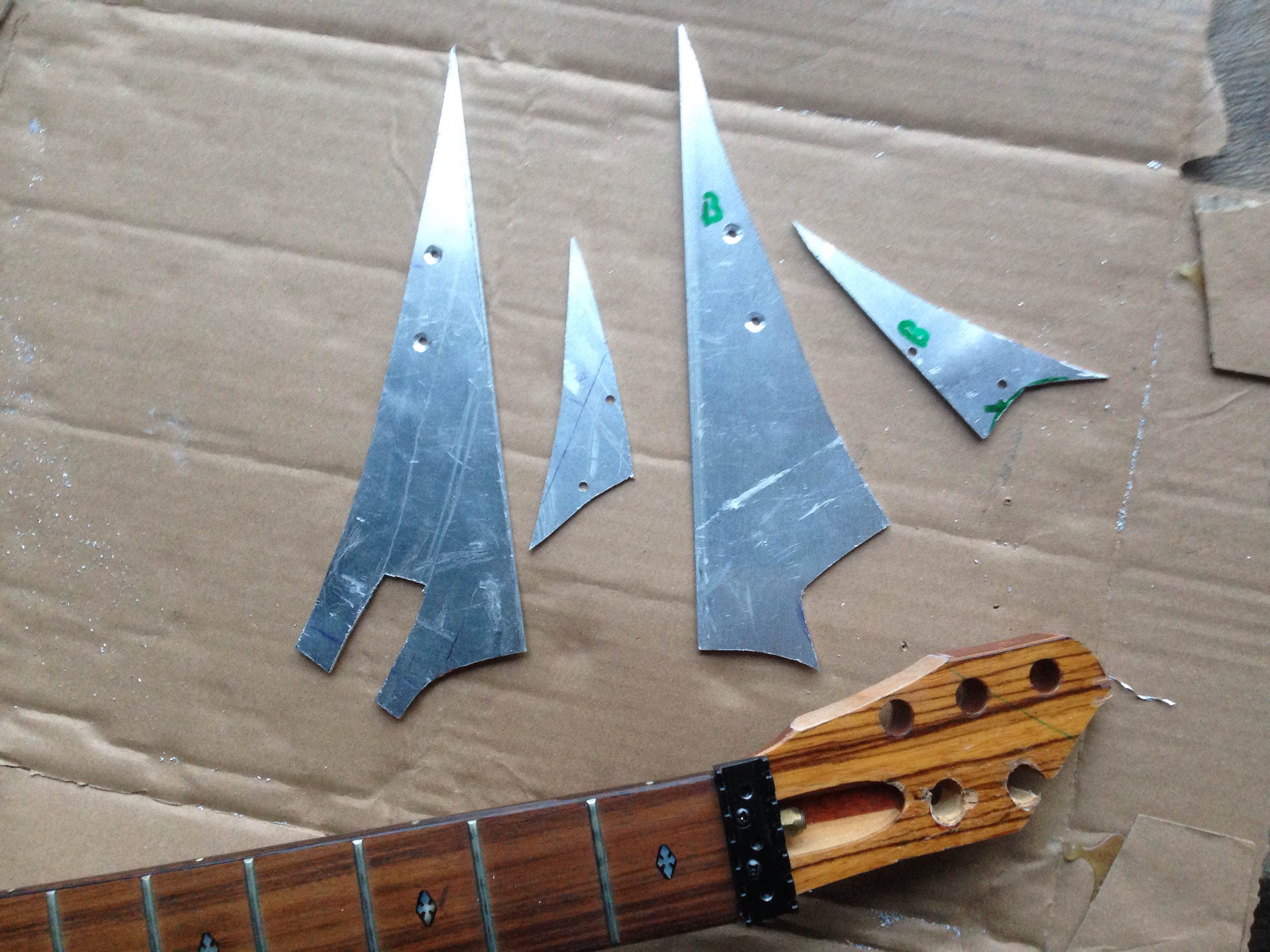

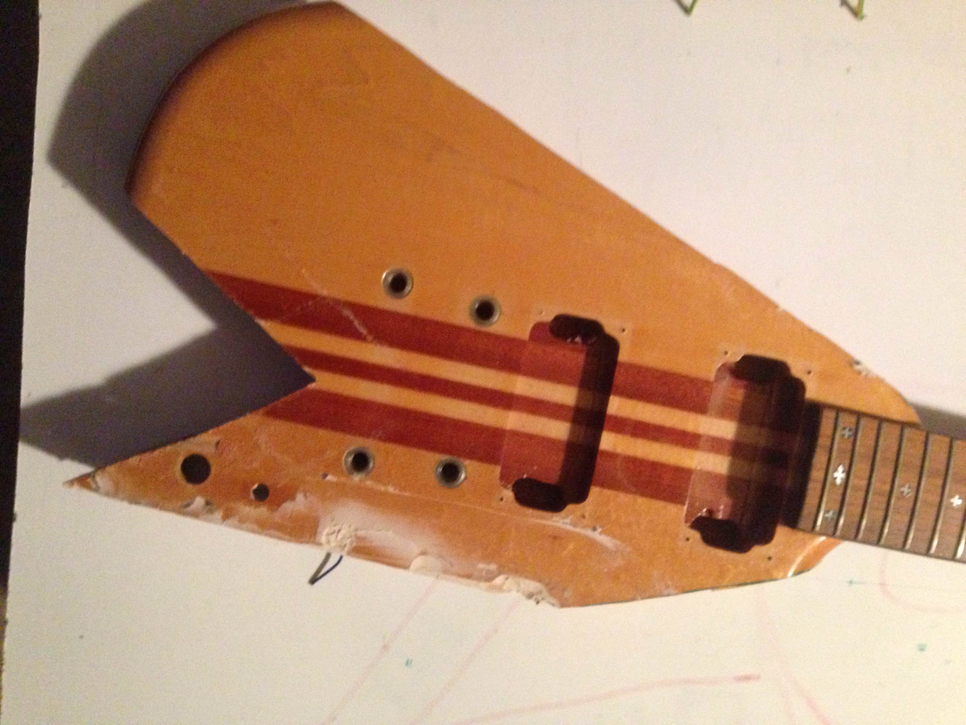

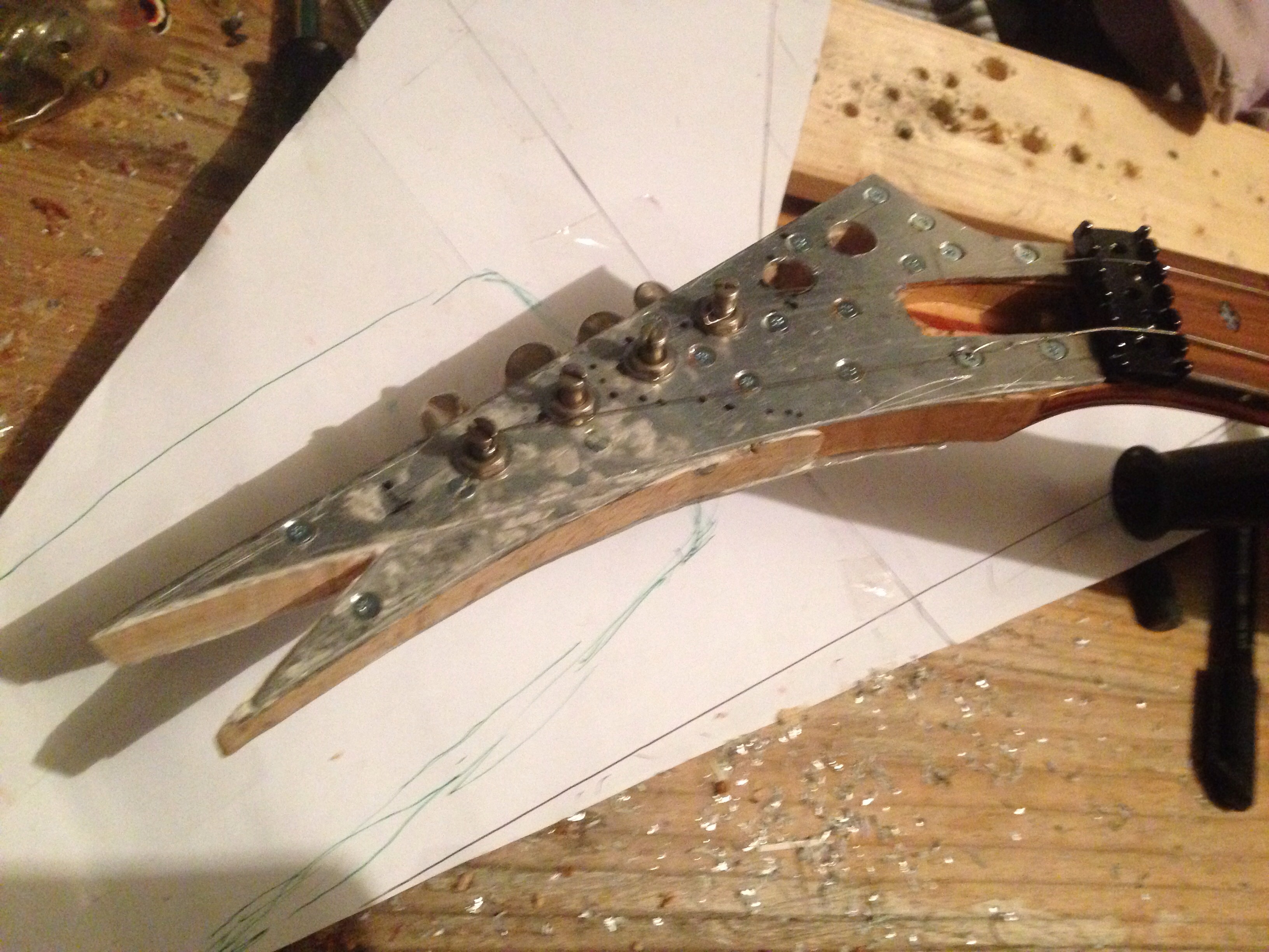

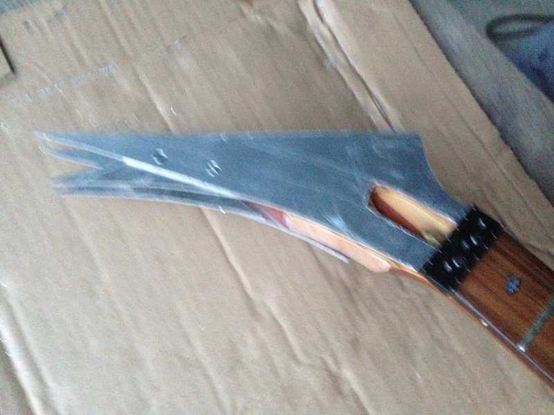

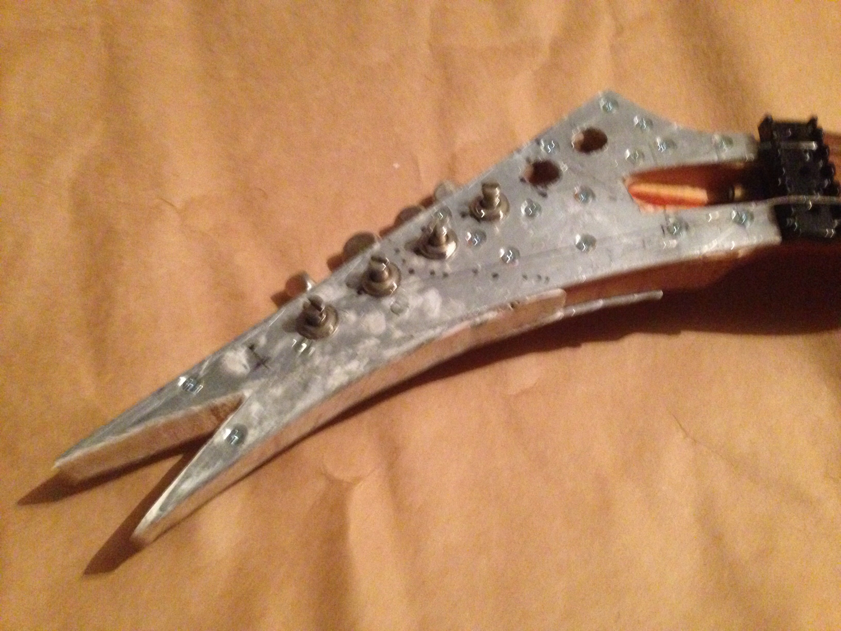

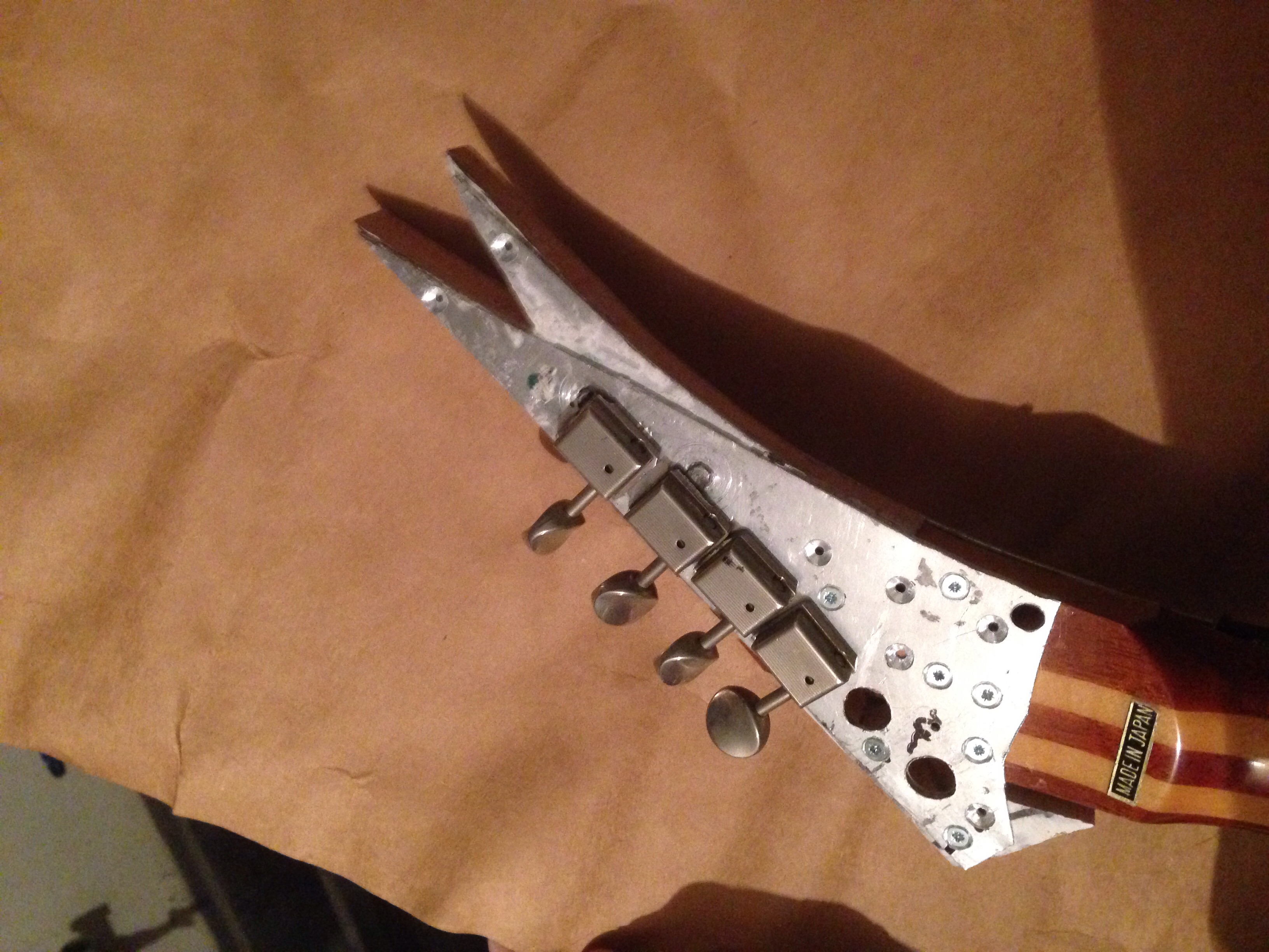

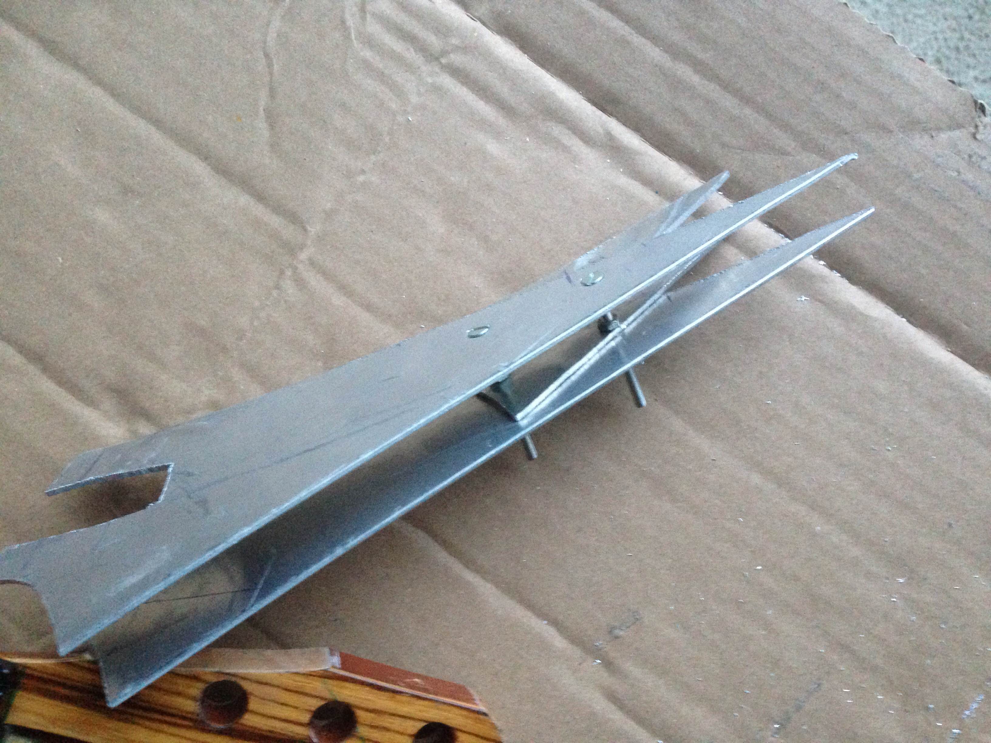

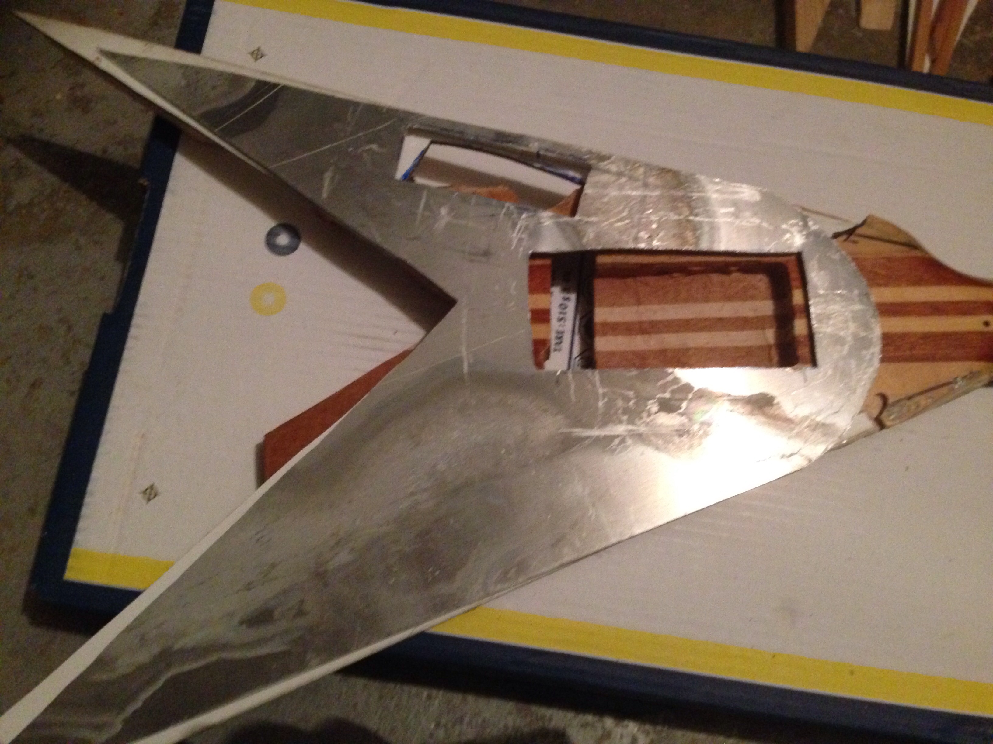

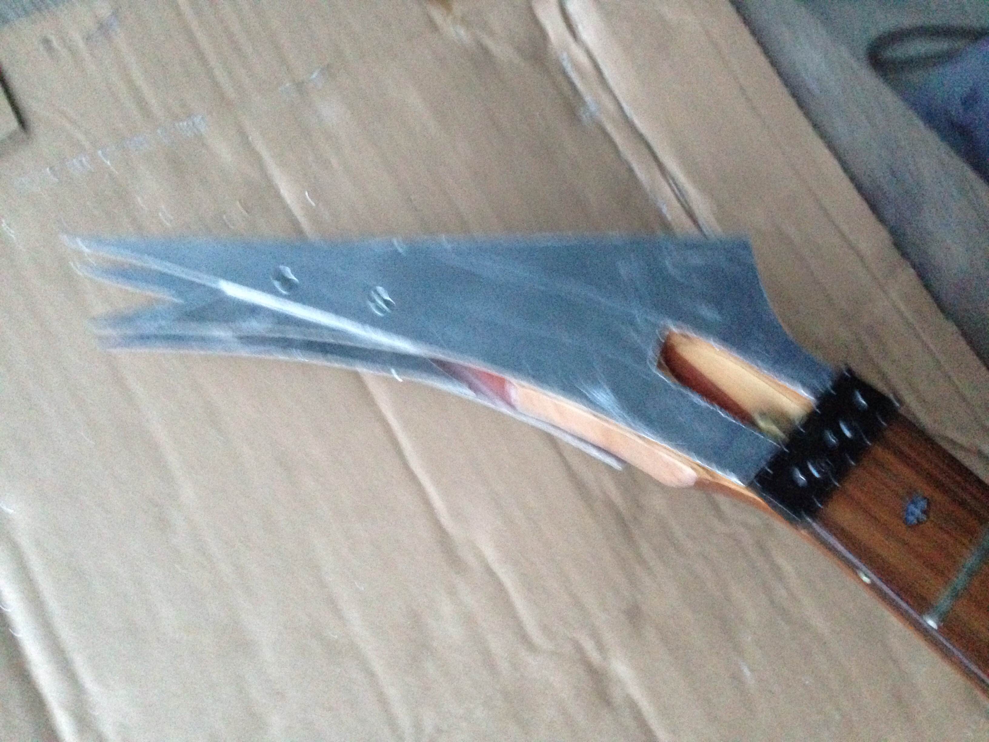

I've been working on the headstock, kind of AZG shape 8) 8) .
Aluminium allows me to make those edgy shapes.
At the end, paint will cover everything.
My headstock will be a deadly weapon...

Cool stuff
Re: My VV project – work in progress…
This going to be interesting and I think that you are courageous!
That headstock is IN-FUCKING-SANE !!!!
Actually, I wonder if a Speedloader Floyd Rose would suit this better?? No tension on the headstock at all!

Awesome !
Looking good :)
Keep the eyes away huh? Yikes

This headstock is as screwed as Vinnie!
I tried the Floyd with two strings. Seems to work

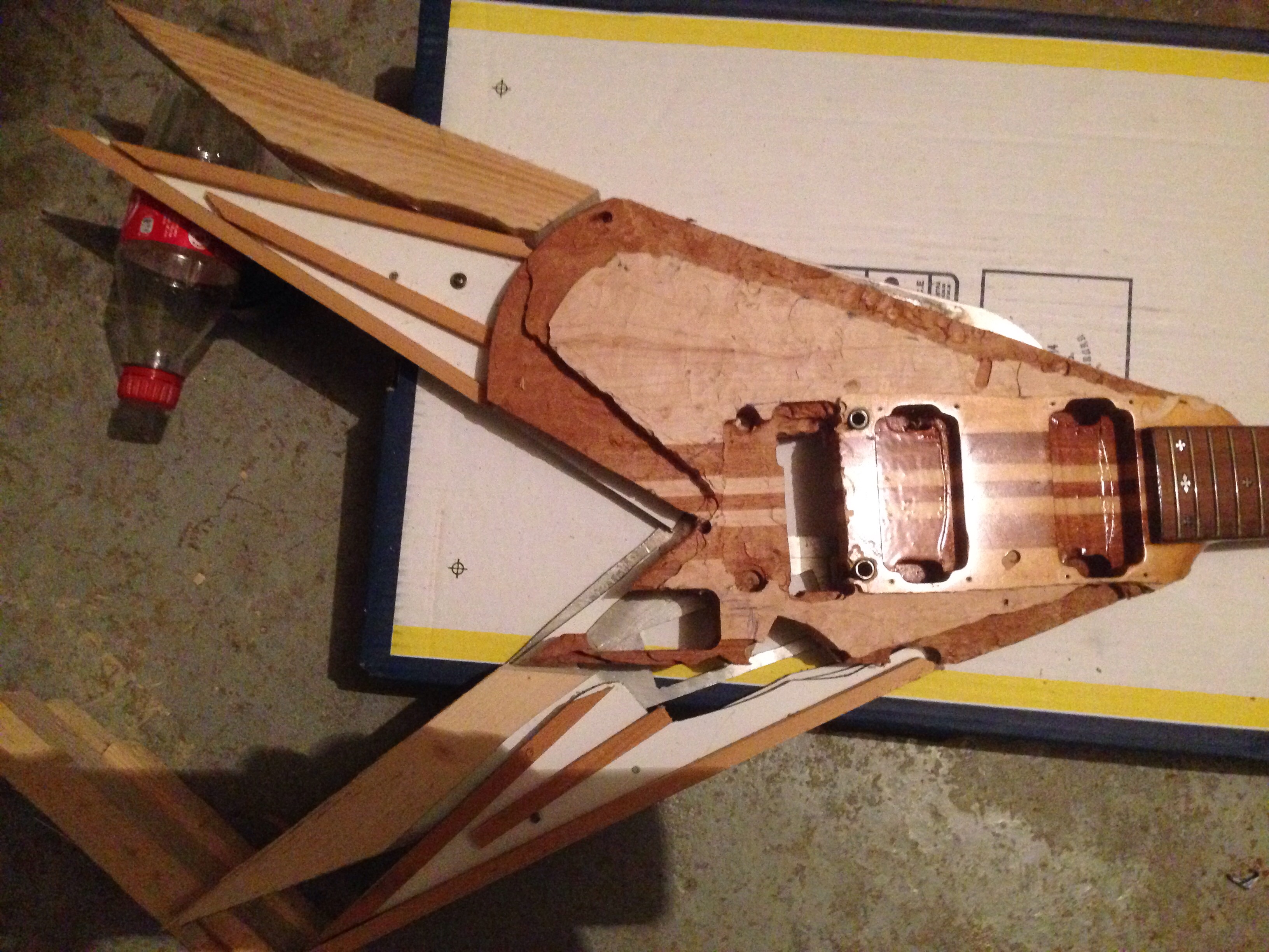

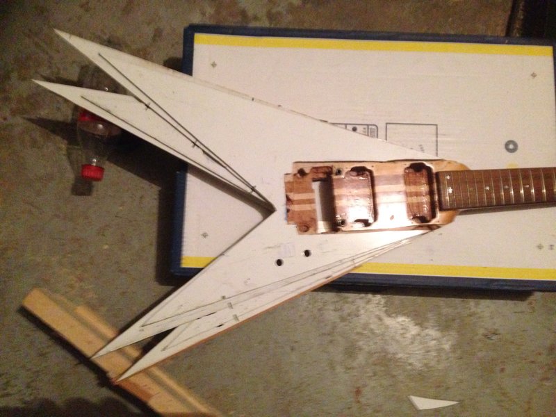

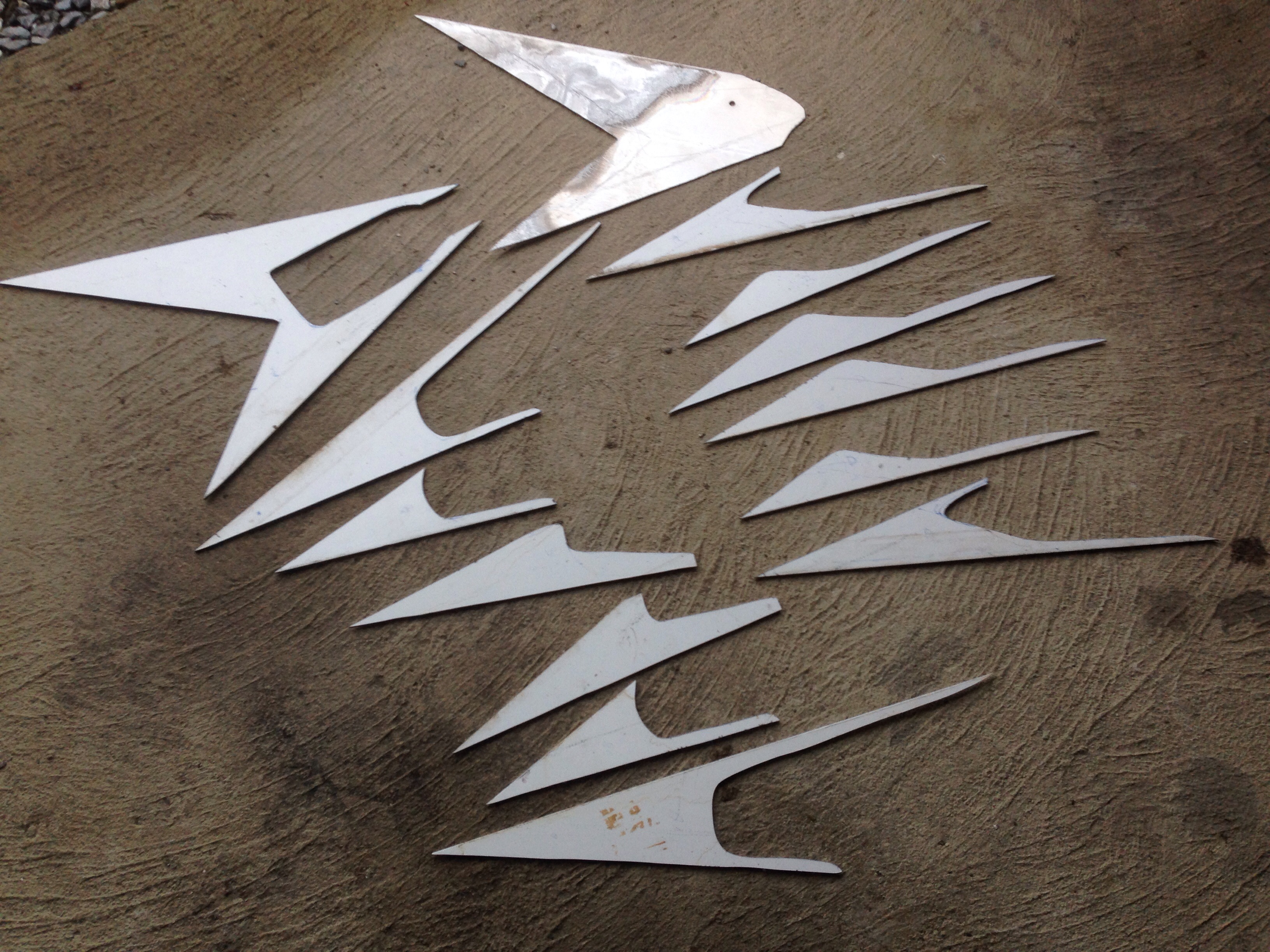

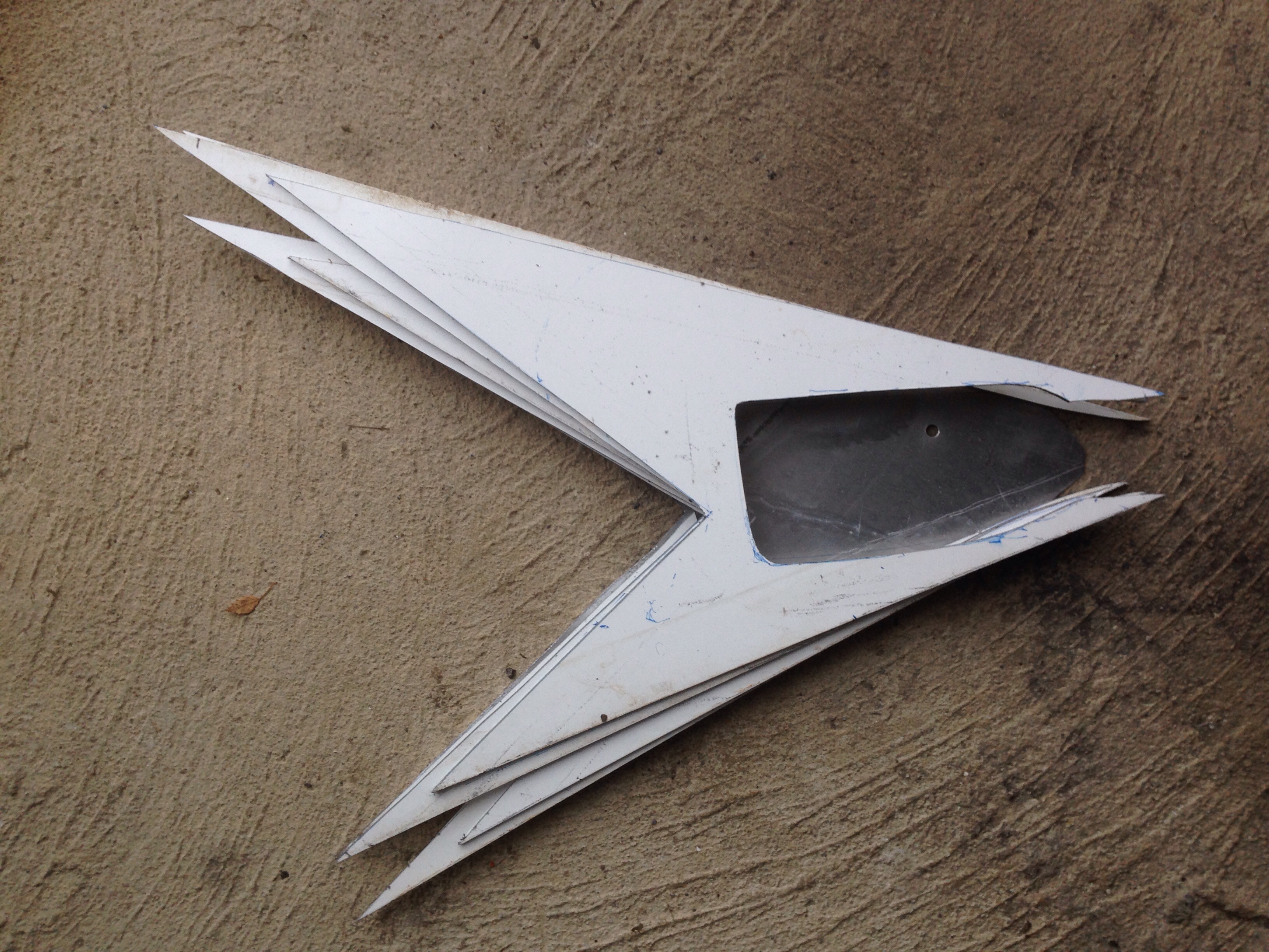

Lots of V's for today!

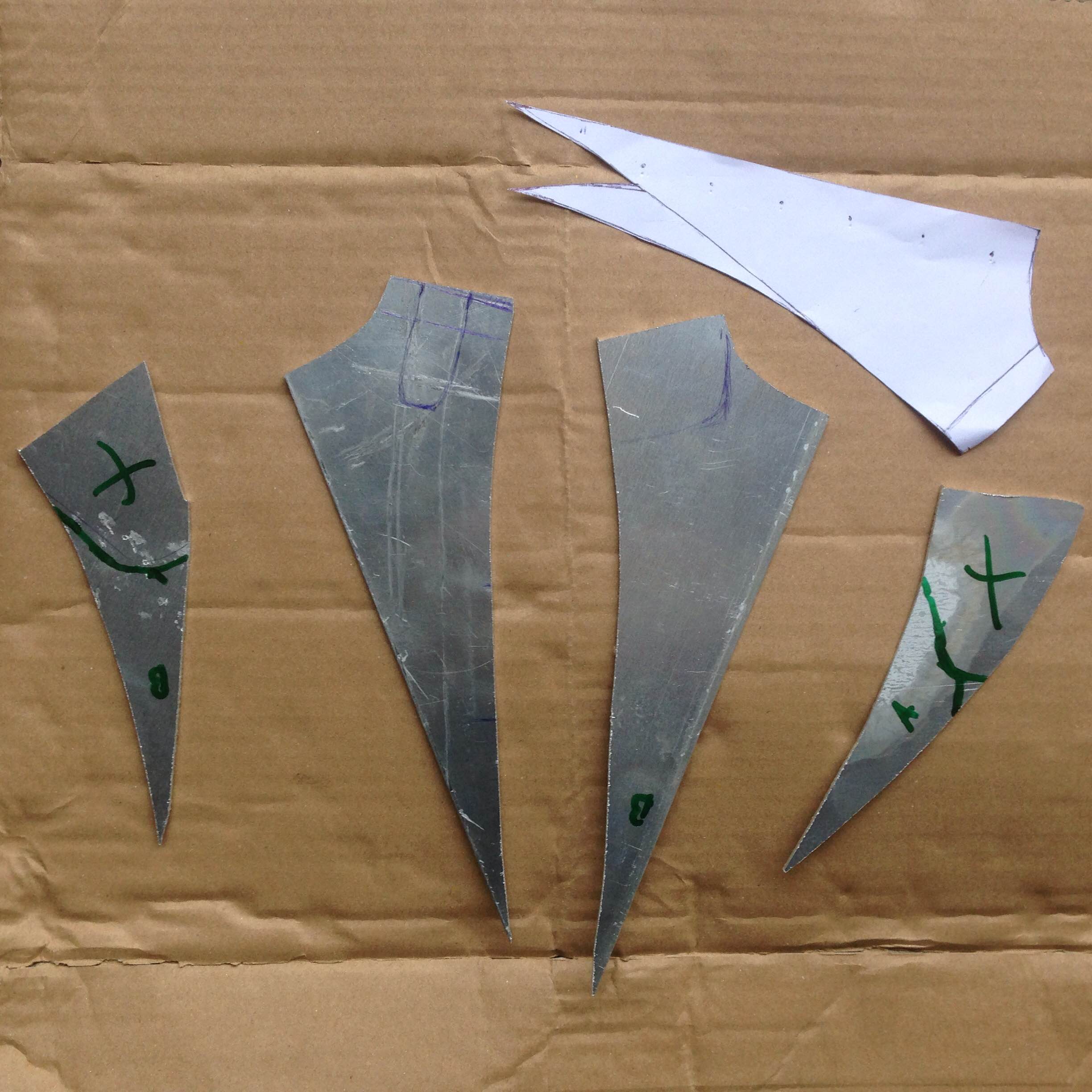

Now I ve got to do the same thing with the back...

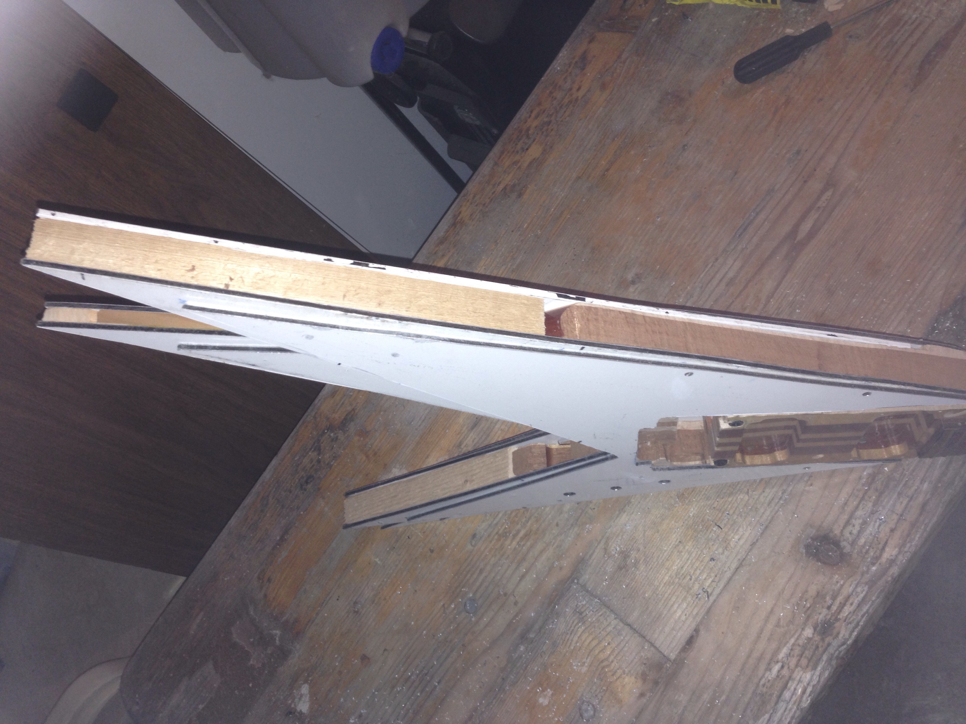

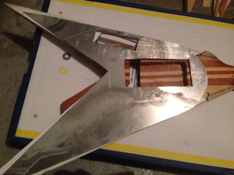

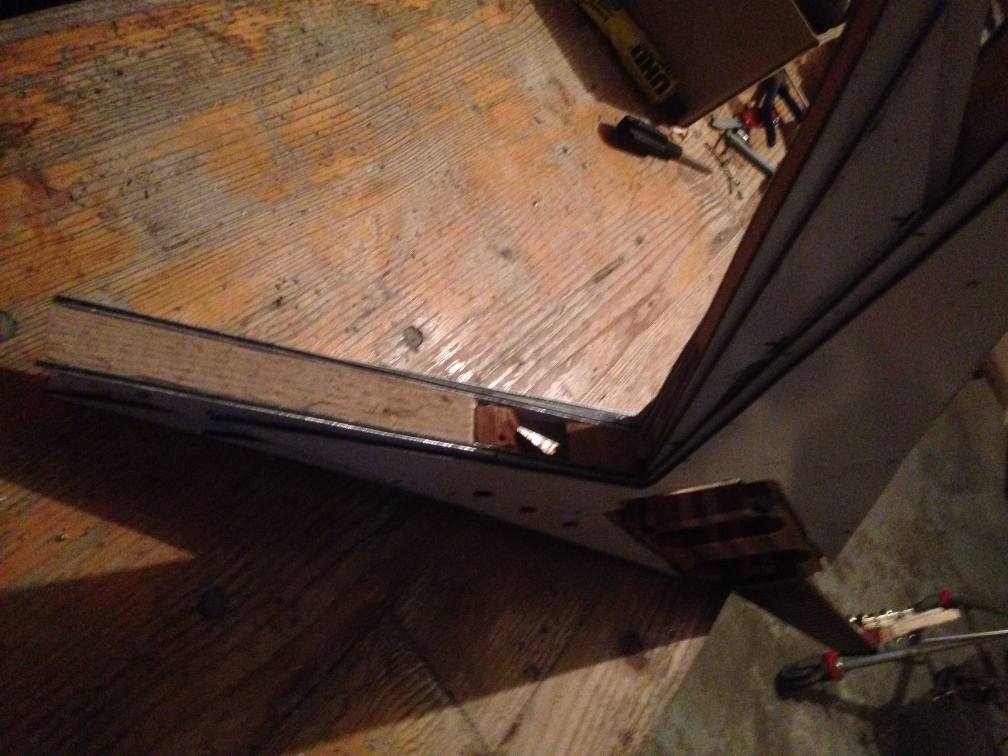

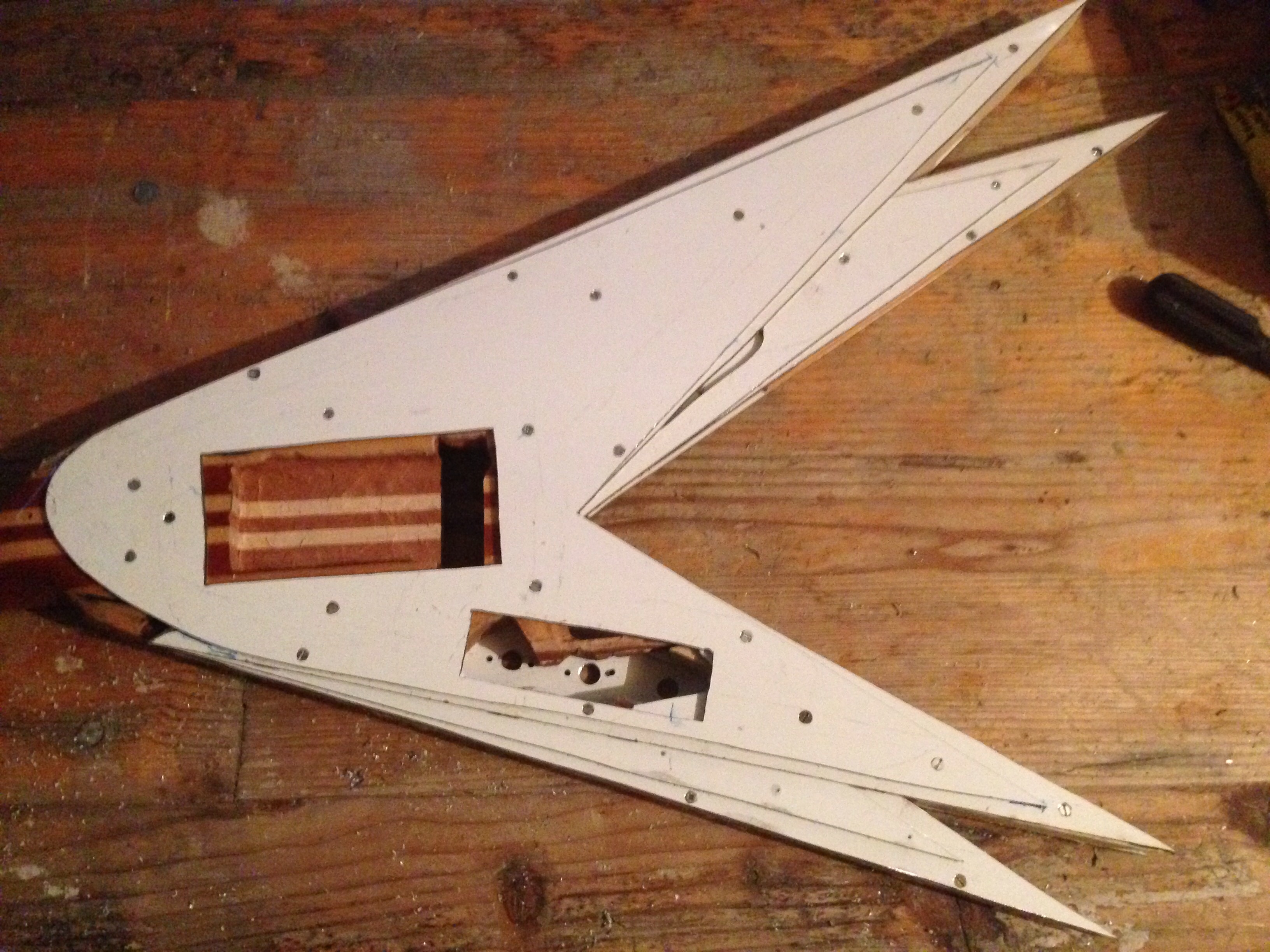

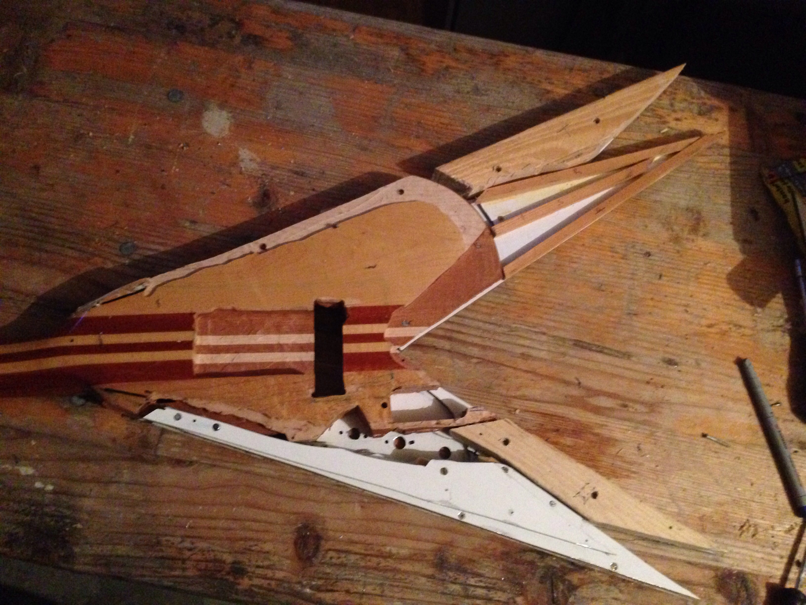

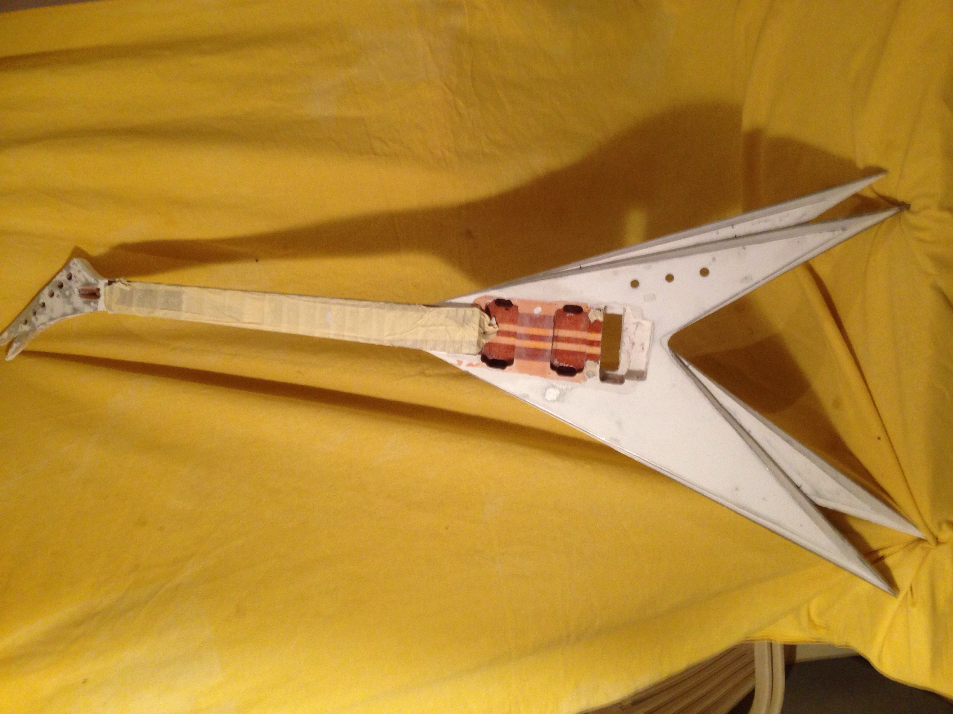

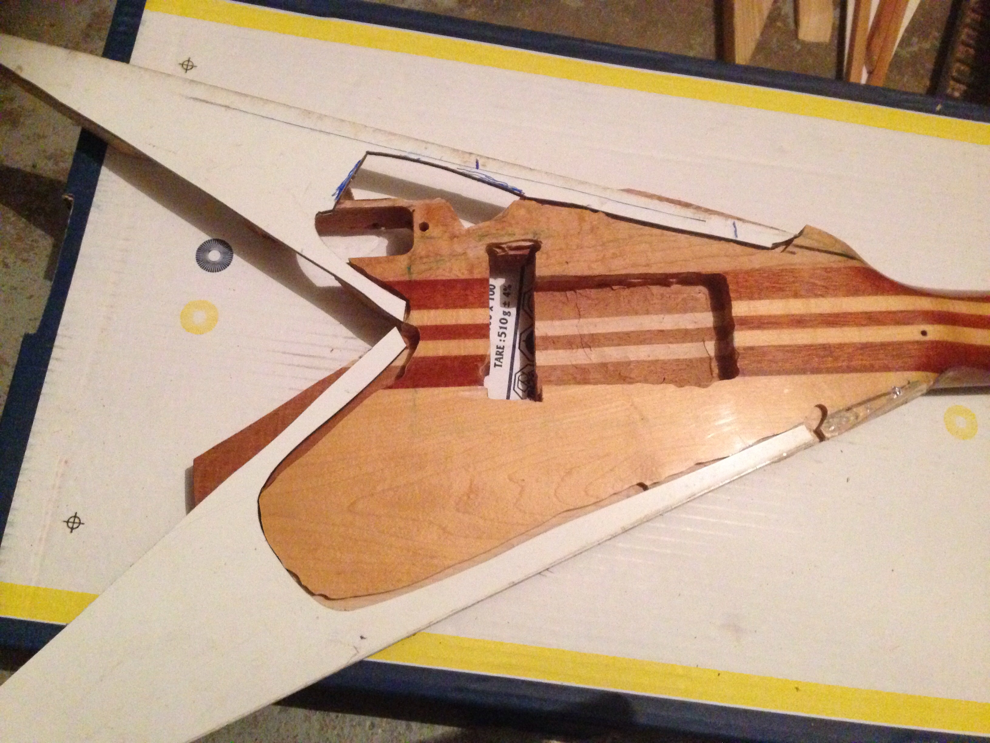

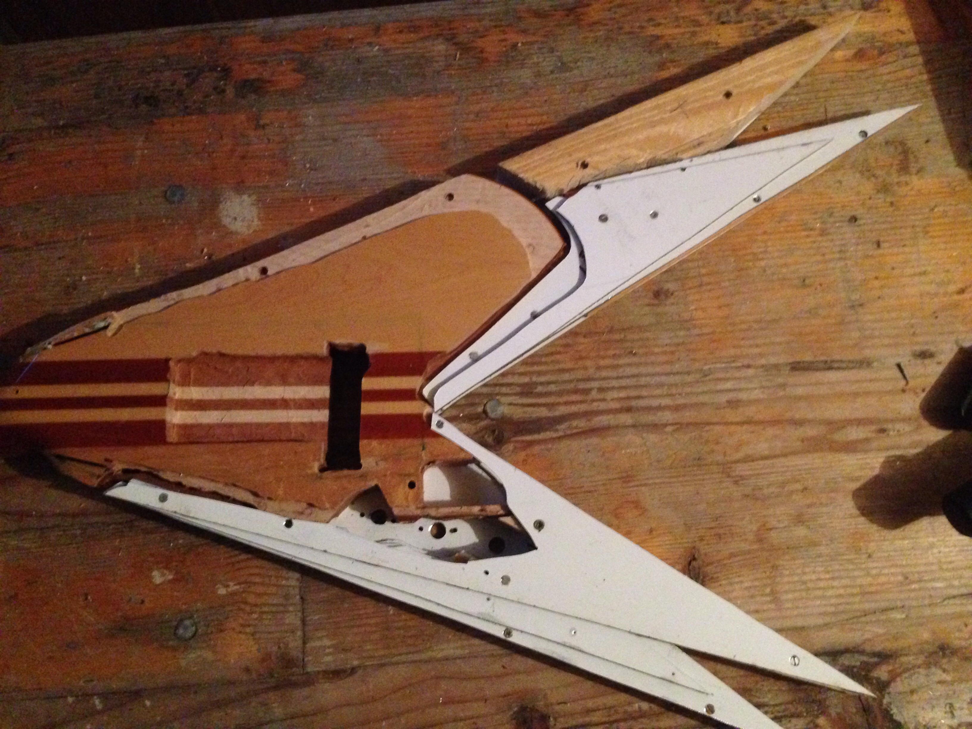

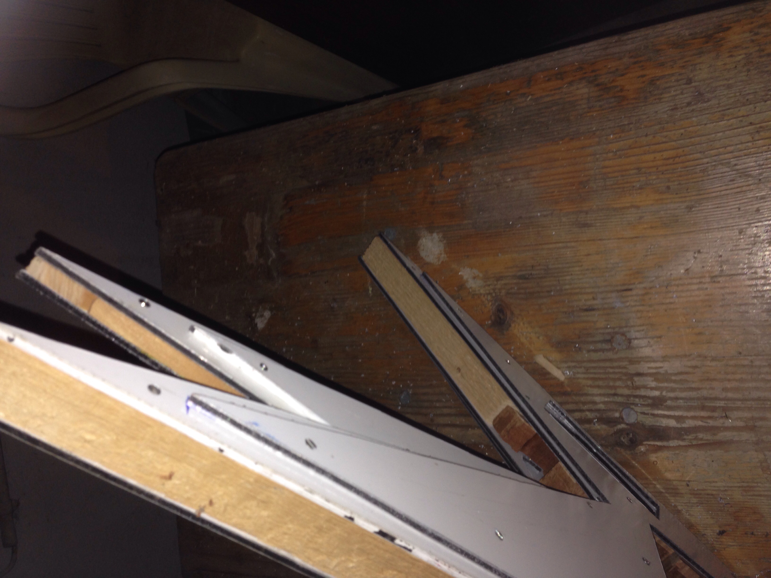

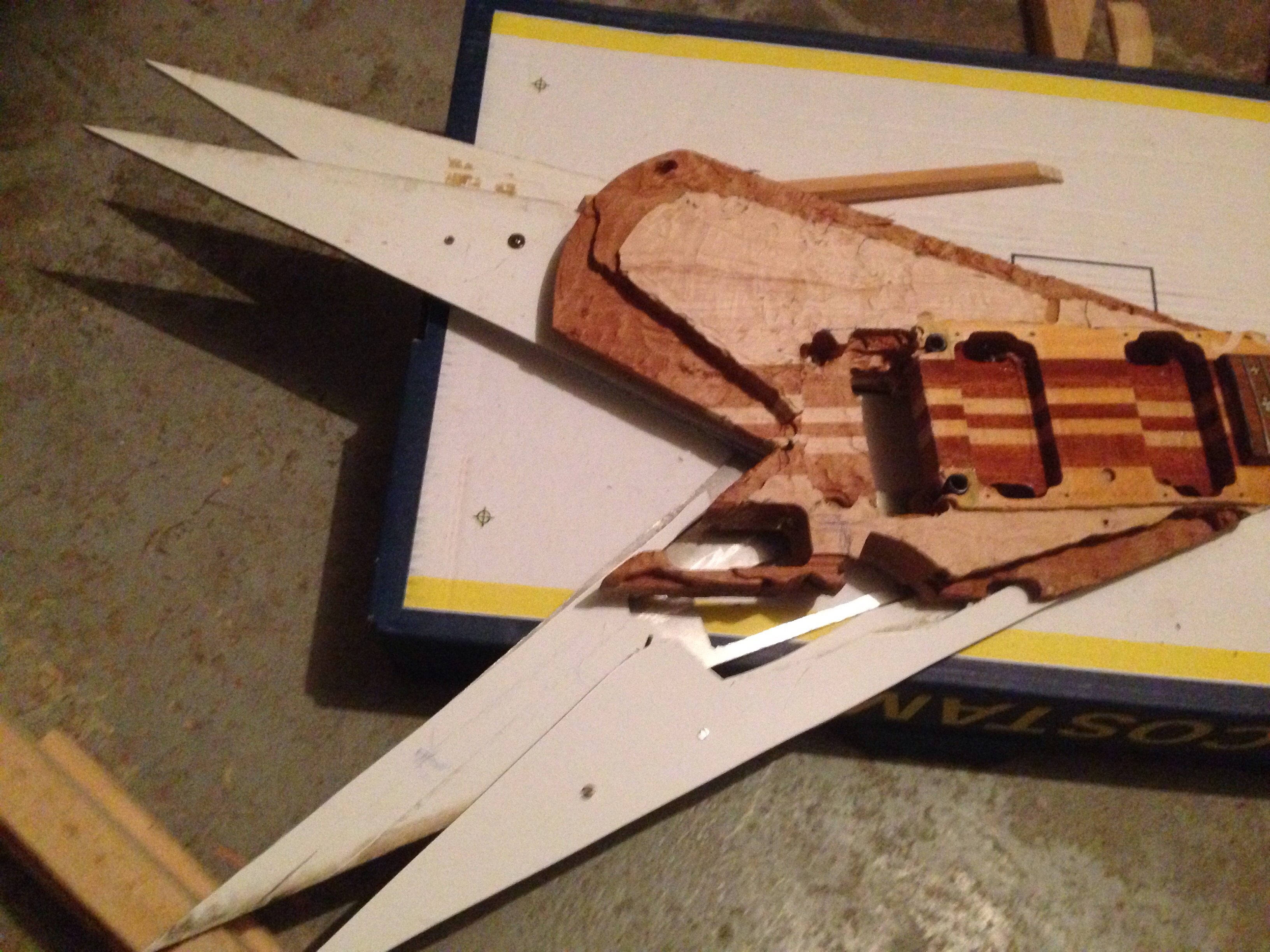

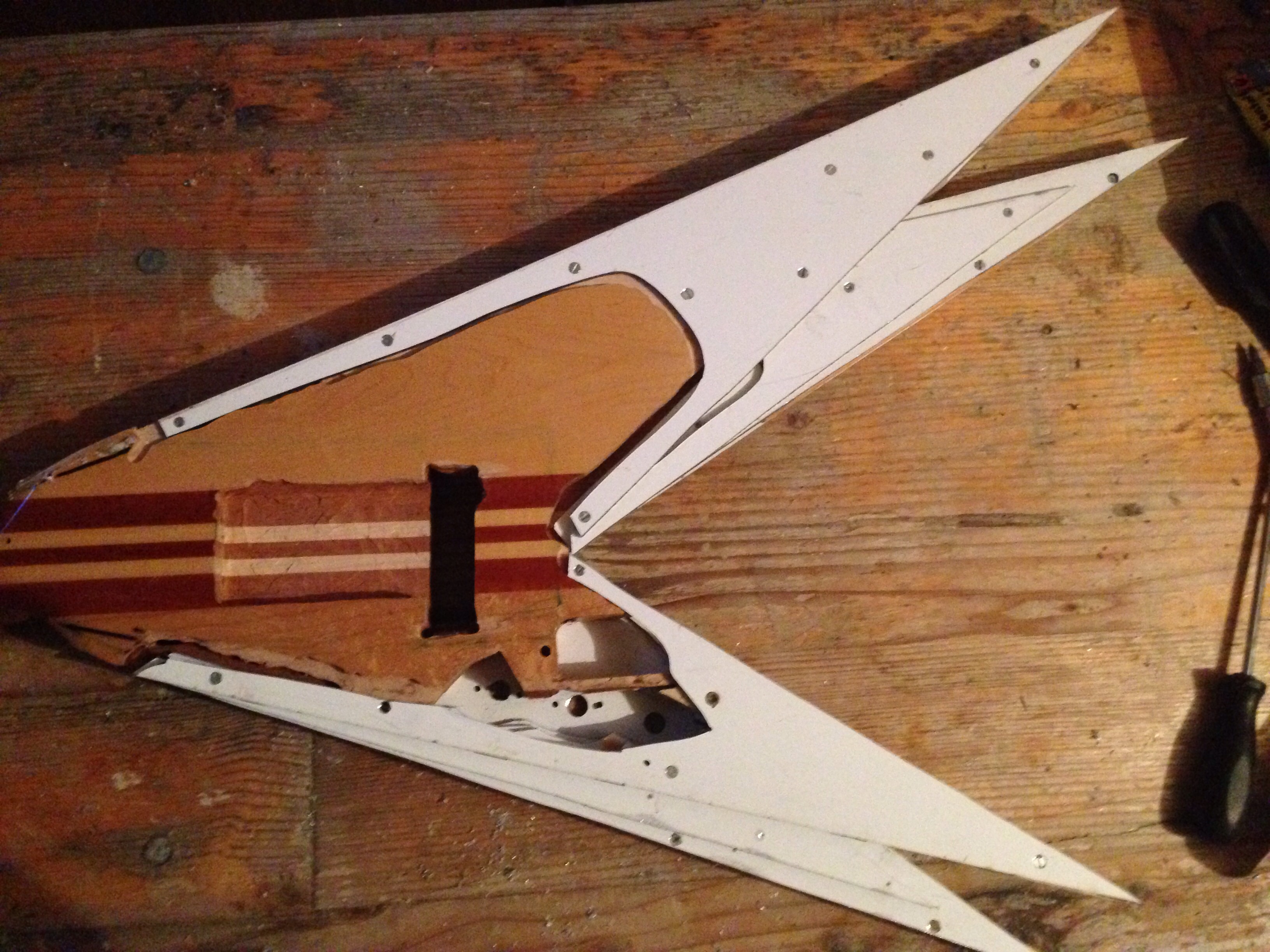

... a few pics before mastic/filler and screws, lots of screws...

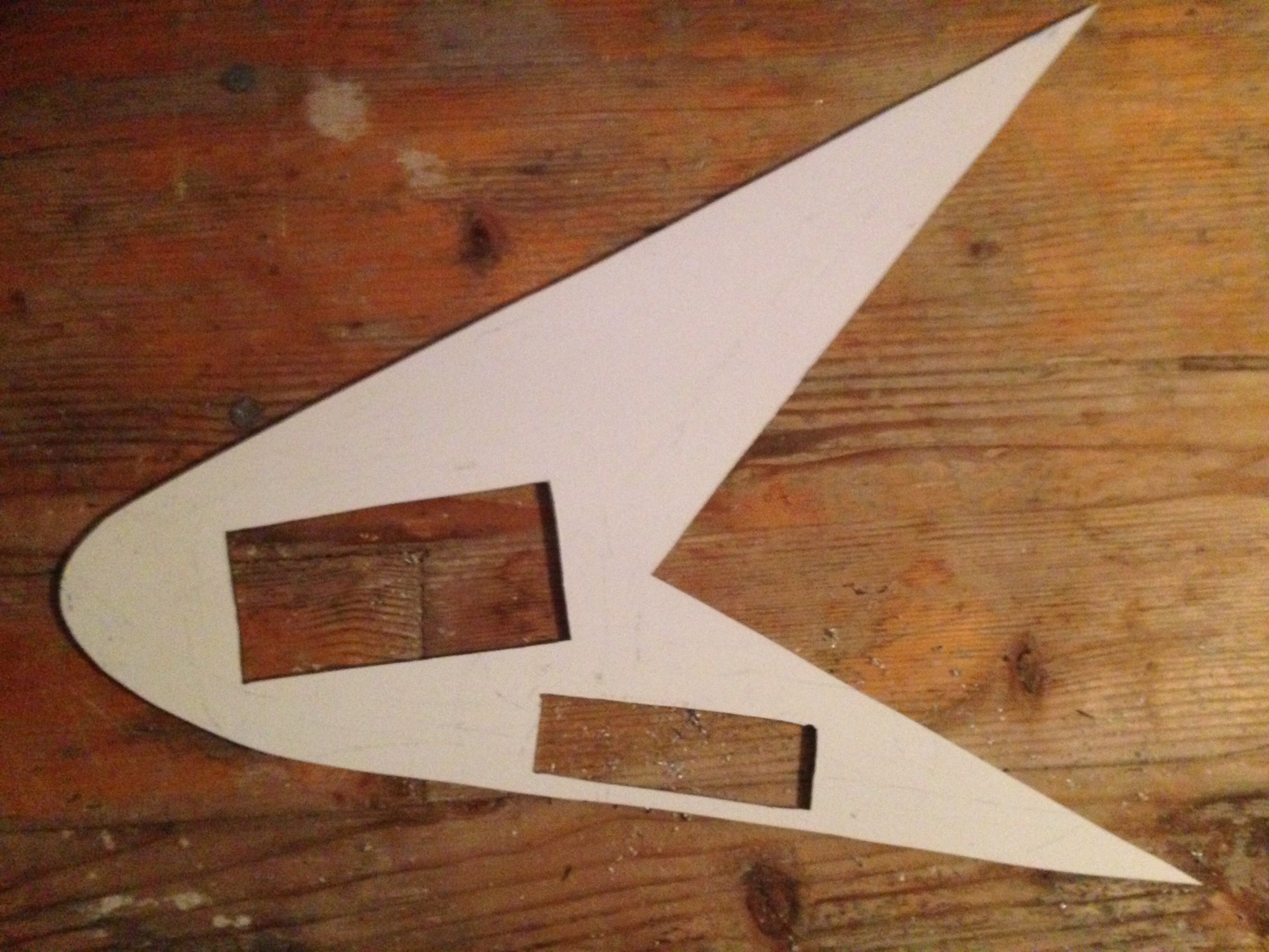

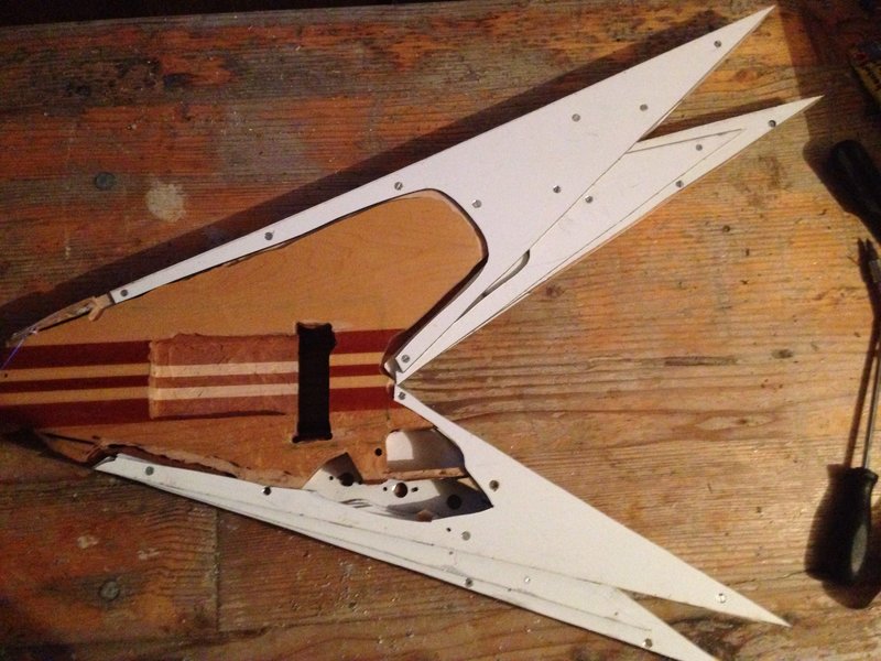

Screws are done. I did another back piece, because the other one wasn't ok.

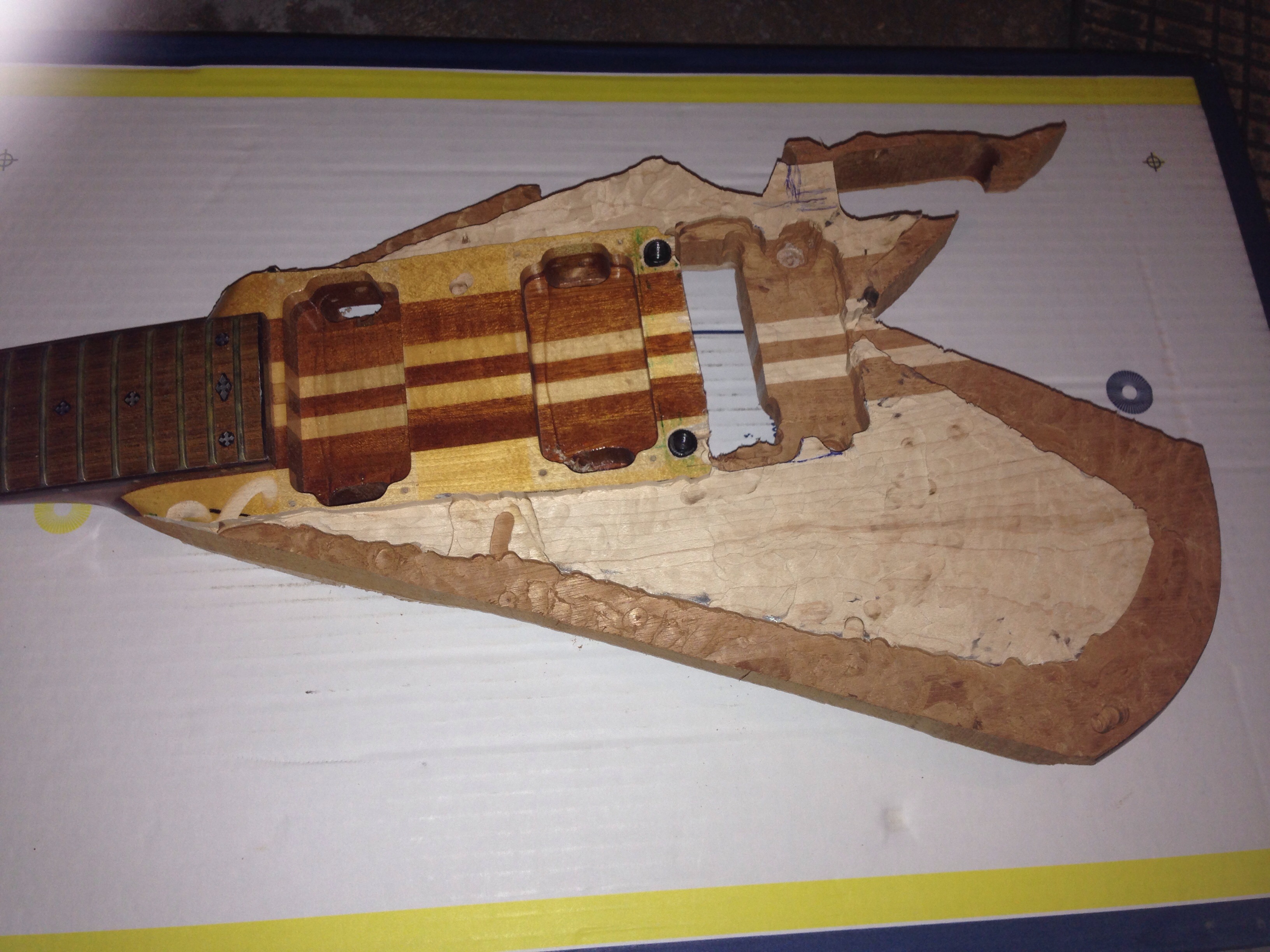

This is really so creative. Never in a million years could I have imagined doing something like this but this really looks cool. How did this guitar play before you modified it?

Slayer wrote:This is really so creative. Never in a million years could I have imagined doing something like this but this really looks cool. How did this guitar play before you modified it?
I have no idea... A friend found it in a trashbin and gave it to me. It was half of a double-guitar.
I think it'll sound ok as it is a japanese guitar from the end of the seventies/early eighties.

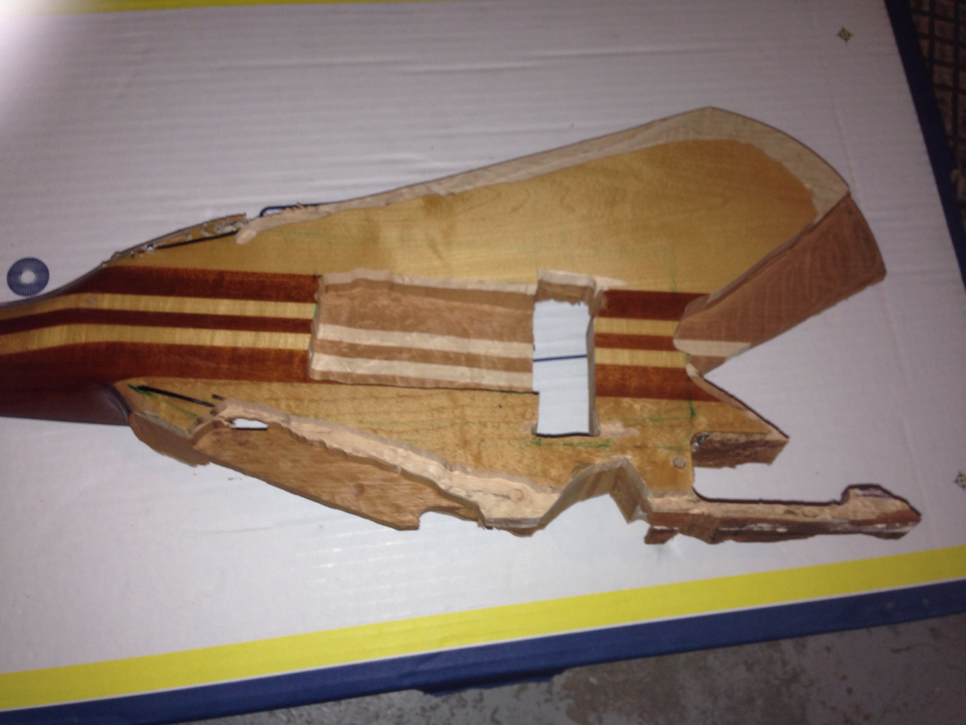

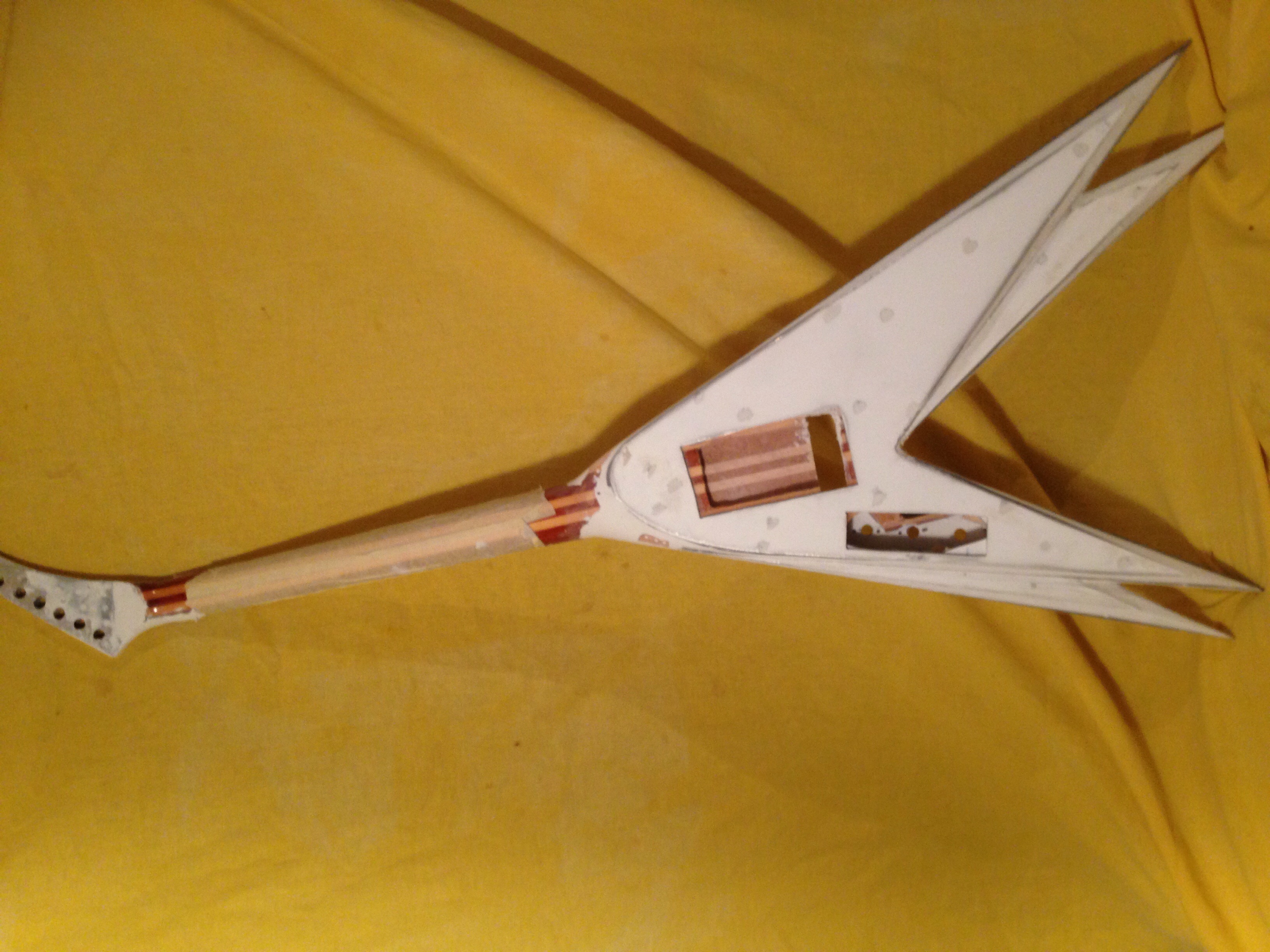

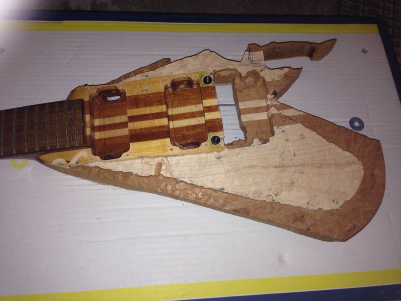

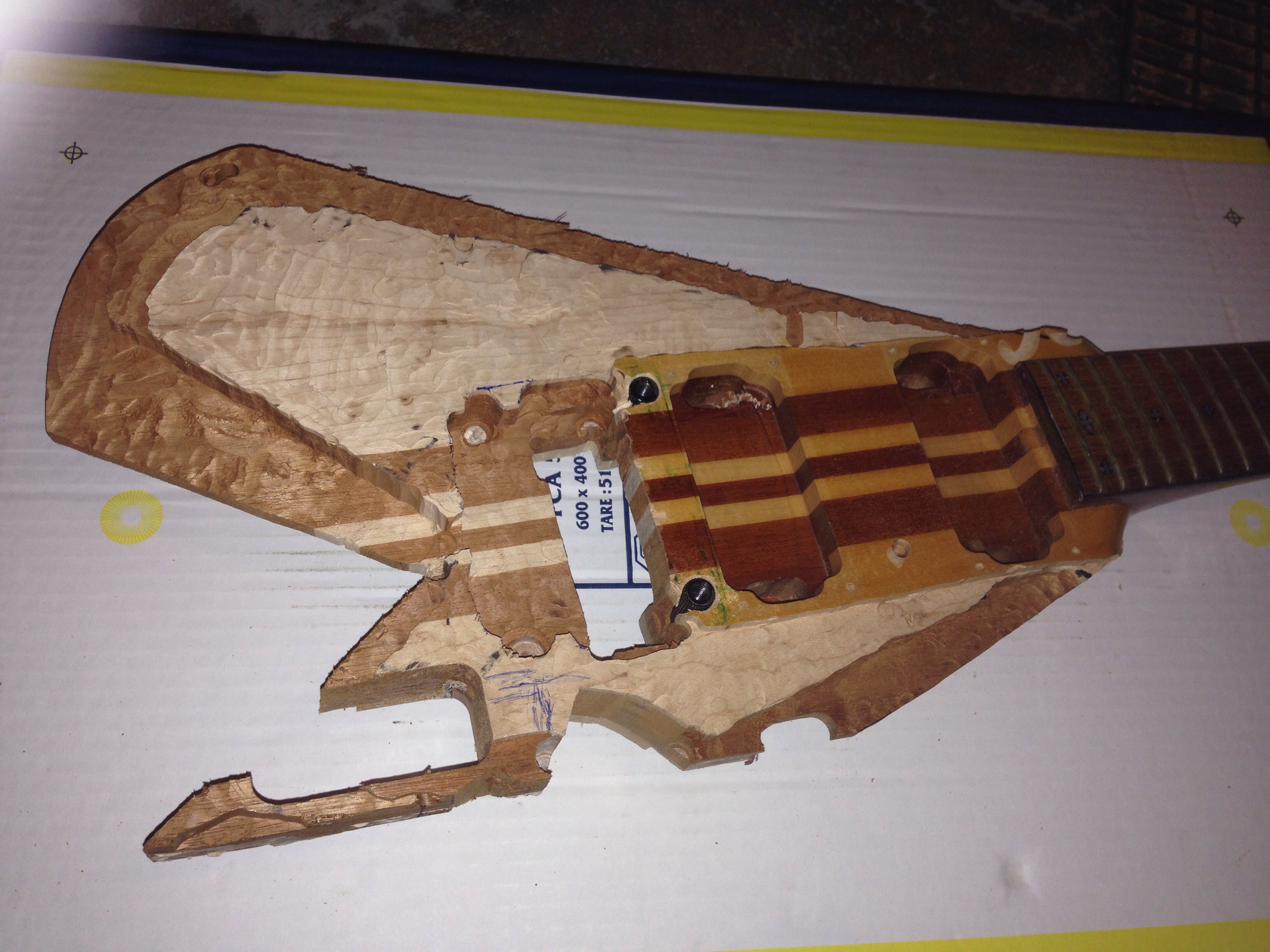

I did some mastic/refill today. Everything gets well hidden...

The neck profile is fine, I think it's a C shape. Unfortunately I'll have to paint it, because wood is not very vinnyish...
This neck is also strangely narrow : I'll have to work on the locking Floyd piece to get the first and sixth string on the frets...

It was like working as a dentist on a big tooth today, with a dremel as dental bur... Wolfi knows about that!
Still have to sandpaper it
Hey, tukoztukoz. Before I ask this question, let me state what you have done is brilliant. But I'm just wondering. Wouldn't it been better to slice off the whole neck, as in you'd end up with a neck thru situation and then attach the wings instead of jigsaw puzzling the thing together.

metatron wrote:Hey, tukoztukoz. Before I ask this question, let me state what you have done is brilliant. But I'm just wondering. Wouldn't it been better to slice off the whole neck, as in you'd end up with a neck thru situation and then attach the wings instead of jigsaw puzzling the thing together.
Thanks for the compliment.
You're right, I even thought the same a few days ago about slicing the neck. I think at the beginning I wanted to keep the maximum of the original wood, and I didn't want any "wings movements", since the plates are made of 2 slices of aluminium and 1 thicker slice of plastic.
I didn't want to work with wood because that would have been a real luthier's difficult work, and those wings are so pointy. I don't have the right machines too, but maybe I'll get one or two woodmachines someday. Woodworking is nice, which is not the case with metal and resins/mastic...
Let's say this guitar is some sort of a poetic artisanal amateur sculpture...
I checked its weight : 3kg500 without pick-ups and metal parts.
